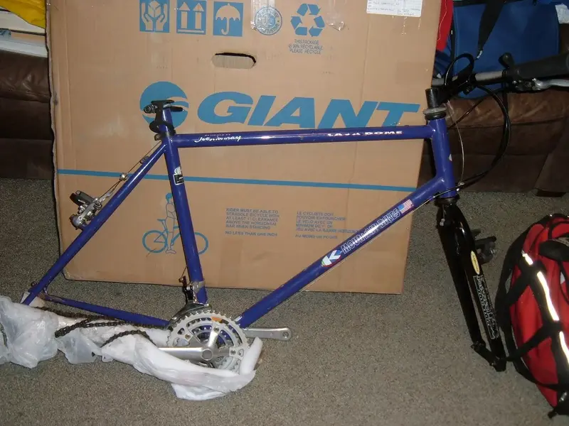

just got my Lava Dome unboxed, it was waiting on the front porch when i got home this evening!!
its got the wrong rear cantis, and i will be looking for a fd-m735 28.6 BP front mech [i have a rd-m735 to put on it].
i have a sweet set of m730/732 hubs with araya rm-400 pro rims i think will work real well on it.
always wanted a Kona, guess i will be busy this fall.
edit: looking in the 92 catalog scans it seems as if the rear cantis may be right, listed as low profile for the rear? and it did come with a brace for them as the catalog states.
i dont see any down tube decals like the ones on this bike, does not say KONA like the catalog scans and the stem doesnt have the cable guide like the scans.

for what i can tell the measurements make it an 19" frame.
most components seem to match the 91/92 spec, the crankset[500 LX],thumbies[Deore DX][91 catalog says rapidfire?, 92 says Deore DX top mount, and it has the thumbies],frt/rear mechs[ 500 LX] etc, though it came without any wheels, and as i mentioned earlier, the stem does not seem to be a KONA velocity stem[brake cable runs through it, instead of guided underneath like the catalog scan pictures][ i will take a pic this weekend and see if anyone can say what it might be ]
seatpost is all scratched up, dont see any markings on it, gonna try and clean it up a bit this weekend but i think overall the bike will turn out great.
It's a 1992 frame, you can tell from the removable seat clamp, whereas 91 had a braze-on. Could it have been sold in Europe? Kona had to badge their bikes as 'K' in some markets at that time, owing to a dispute over the rights to the name Kona.
If it's a size 19, it should have a seat tube measurement from centre of bb to top of seat tube of 19.75". It looks bigger if anything, judging from the head tube. I thought the 1992 size 19 had a 15cm head tube, but that one looks longer.

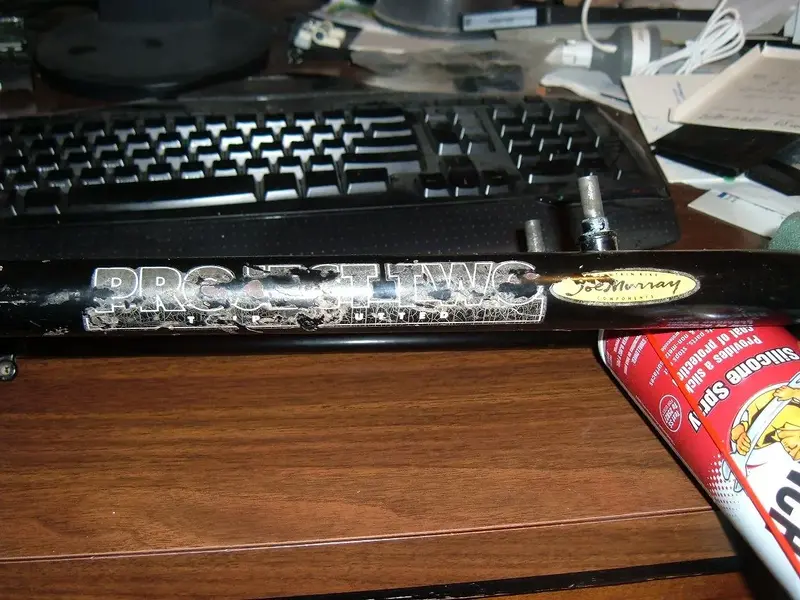

The fork decals are pretty beat up but it does say on the decal that its a project two tripple butted fork, so thats a plus.

As for the size, i was going by the geometry numbers in the 92 catalog [bottom of page 8] i measured after stripping as follows:
center of BB to top of seat tube = 21 1/4"
center of BB to center of top tube =18 1/2"
center of seat tube to center of head tube = 23"
rear dropout to fork dropout was measured at 42 1/2"
the catalog states that the 23" top tube and 42 1/2" axle to axle corresponds to a 19" frame?
decal on top of seat tube say MTB chromoly dubble butted
there is a decal at bottom of seat tube that says "the bicycle group" [seems to be the same as other decals? but maybe not]
there is a shop decal from Century Cycles Bend OR on the bottom of the down tube
and then there are the "K" oval and the "mountain bikes" and the american flag decals on both sides of the down tube [where all the catalogs have a "KONA"]

still trying to figure out whats up with this bikes decals, a lot of the spec seems right with the 92 catalog and it does have a seatpost clamp vs a brazeon the seat tube, but the project two fork is decaled as a tripple butted job, however the catalog does not say this and upon better examination the fork steerer is stamped 1991 and CM/SB so i am going to say its a chromoly single butted P2 :-(
still havent figured out the downtube decals saying "mountainbikes" instead of kona either.
stiil, its kinda cool so i will procede, and it is what it is.
