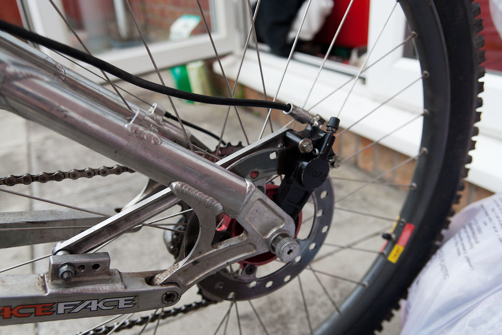

I cant figure this one out, I have a floating rear hope brake for my Lobo, and I have fitted some hope bulb wheels on, and I dont see how I can attach the brake now, - do I need special wheels/hub/converter for it? - please help

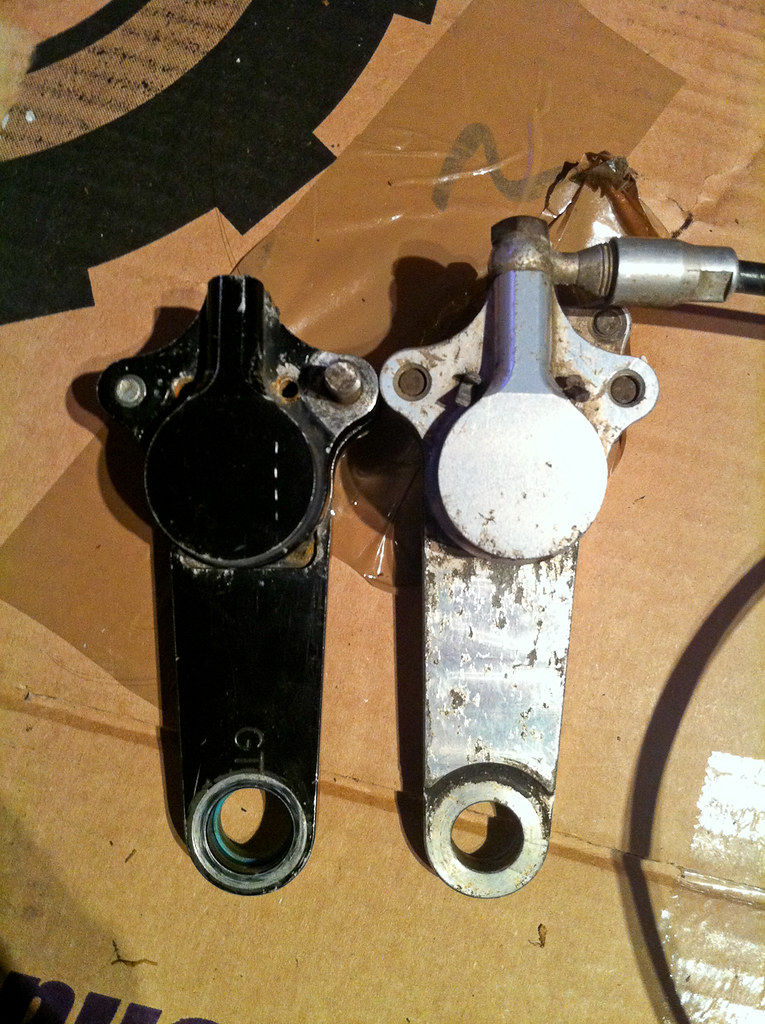

See my bike, black one is stamped GT and the other was a spare I picked up, No2 I believe. GT Caliper is 155mm disc and the No2 I have is 165mm.

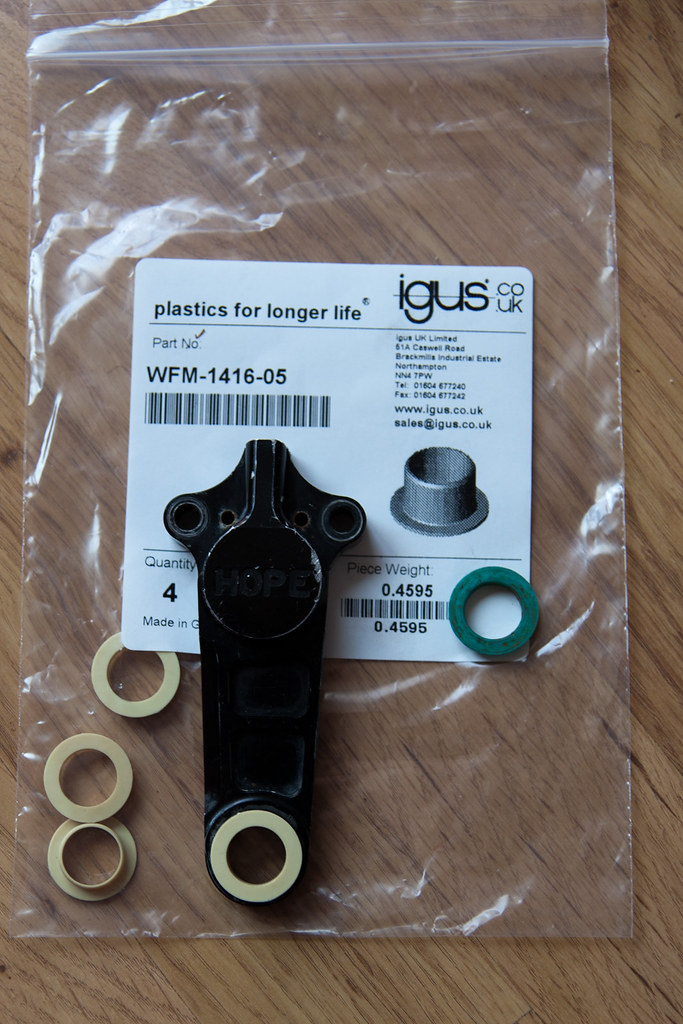

Just to add..my plan (as I now have two Lobo's and only one GT brake) is to have the No2 caliper hole bored out to take the bushes you see in my pics and have someone make the dropout bolt.
