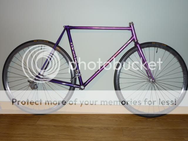

This will probably remain mine for a while atleast:
Obviously needs parts changing, actually every part! I intend to fit one of my Campagnolo Engraved groupsets (11 speed Athena perhaps, maybe 10 speed Veloce, Athena Mix). Quill stem of course, silver seatpost and decent saddle.
Not sure what tubing it is, the only other one I can find is on LFGSS in the classifieds section which the seller thought was 653. Was drawn to those spearpoint, webbed lugs and just check that fag paper clearence between tyre and seat tube!
http://s597.photobucket.com/albums/tt55/Telsun/Omega/
Can anyone shed any light on the build? I'm thinking about contacting Mark Reilly who now works for Enigma cycles to see if he can give me some details.

That’s a very early frame, most likely 1994, back then I used mainly Vitus tubing. The lugs are Long Shen 300 series, arrowhead. Still use them now, lovely!
Yes very close clearance but I tried it with a different tyre/ wheel combo and it was a little better:
I think perhaps some 20c tyres are in order.

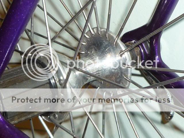

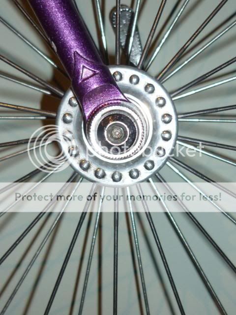

Wheels are Campagnolo Cassette hubs on de-badged Rigida DP18 polished rims. Radial laced on the front and on the non drive side on the rear, cross spoked on the drive side (rear only ofcourse!)

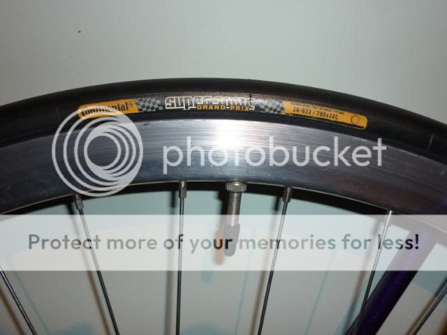

Tyres are 20c Continental Supersonic which I chose to increase the gap behind the seat tube. They are also an extremely light folding tyre so should help create a lively ride, although DP18's are not renown for their lightness.

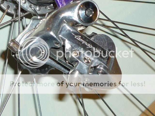

Rear mech is a polished Veloce 8 speed. It was polished by Laz and sold onto me. I actually brought it just because it was a perfect base to try out some engraving on rear mechs which is doable but rather expensive! Looks good and perfect for this build:
So this is how it looks so far:
