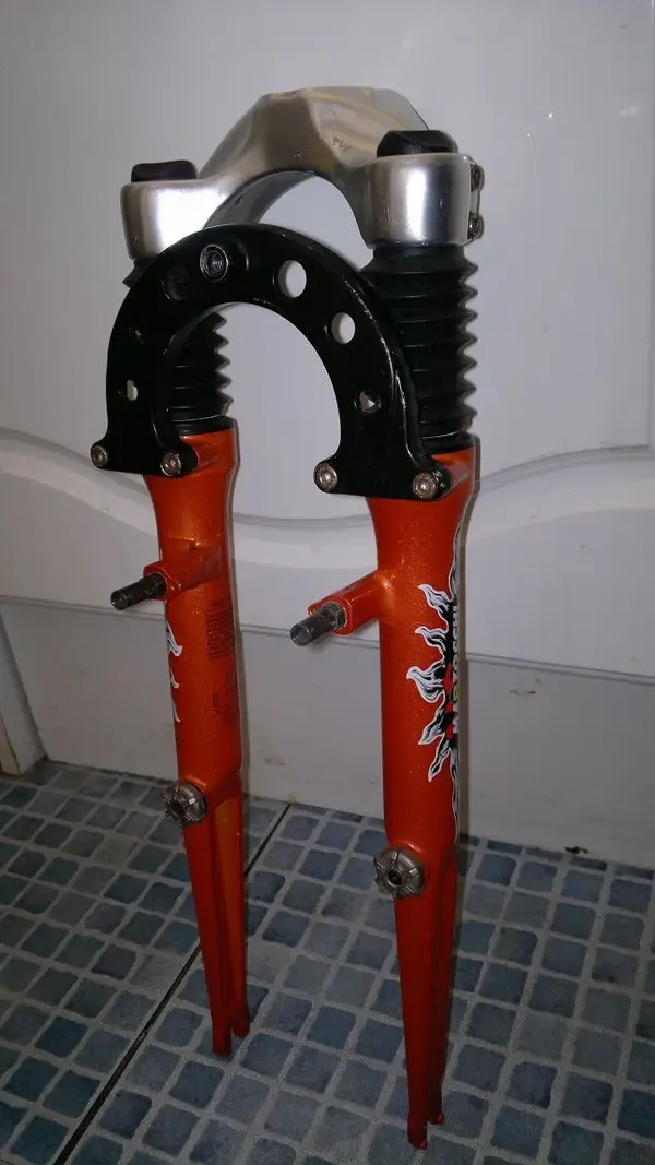

I purchsed these back when money was no object and put them away for later,
aparently it is now later, and they are itching to jump on my 531 tubed cape wrath only I cant remember what model they are or how much air to put in them for a willowy 110 kg individual.
I am also struggling with the ally spacer for 1 1/8th steerer tube I have both steerers but no spacer for the 1 1/8 th to fit it in
any knowlegable marzocchi fans want to help me out ?
cheers
Darren

OK OK I have now looked at the incredibly difficult to read sticker and have come to the conclusion that they may possibly be xcrs as suggested.
it's not my fault the xc bit was cunningly hidden by the little people under the graffix !!

XCR
XCR should be right. Don't know why, but there exists a unbelievable number of special coloured XCR's on the world with it's own stickers ... (?).
XCR has 50mm travel and 26mm diameter tube.
If you still need an adapter or spare parts drop me a note - I have them all ;-)

Yes its an MY97 XCR and without looking at my 97 Catalog they came in Tangerine Dream (as pictured), white and yellow.
