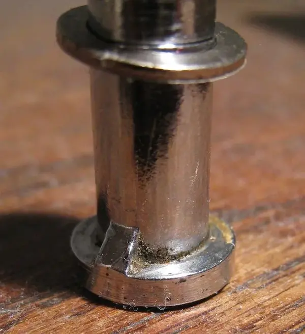

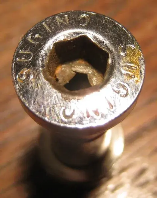

Gazelleer Retro Guru Feedback View Aug 31, 2011 #3 Originally a Sugino bolt was used with a small tab like this: Attachments IMG_4146.webp 45.8 KB · Views: 854 IMG_4145.webp 39.4 KB · Views: 852

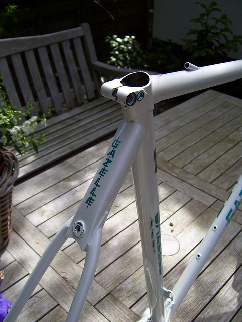

Elev12k Moderator BoTM Winner Gold Trader rBotM Winner Feedback View Sep 2, 2011 #4 ...or are you looking for one of those long recessed ones?
Elev12k Moderator BoTM Winner Gold Trader rBotM Winner Feedback View Sep 2, 2011 #5 The one you need for this kind of clamp >> If so, I've less than I have frames needing them So, sorry.
Gazelleer Retro Guru Feedback View Sep 3, 2011 #6 You might be able to use a recessed brake nut and a M6 allen bolt for the last one, but I am not sure...
Elev12k Moderator BoTM Winner Gold Trader rBotM Winner Feedback View Sep 3, 2011 #7 I tried. Recessed brake nut + 30mm m6 allen works fine.
