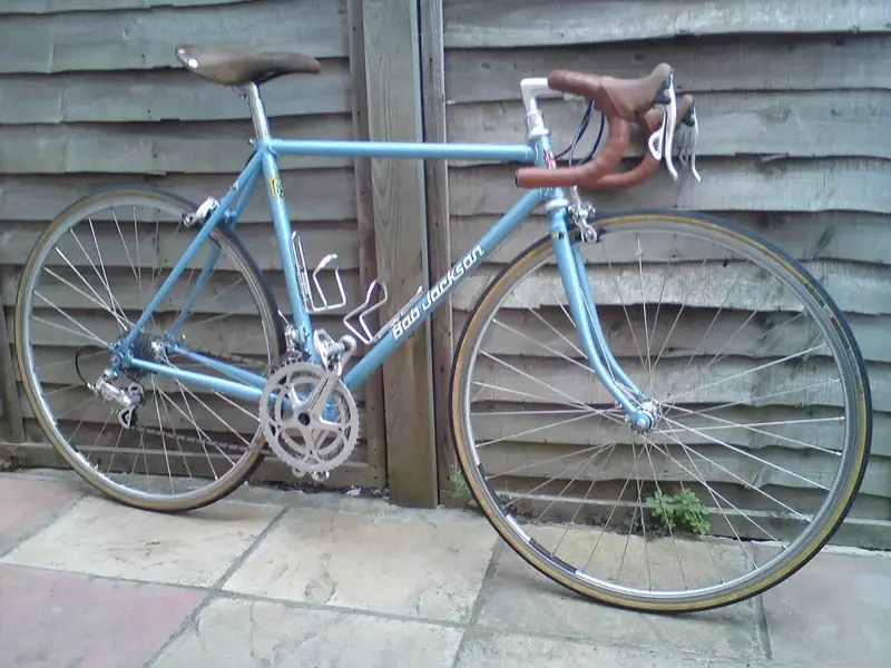

I have a similar build, mainly Italian bits on an English frame - a Bob Jackson Audax Club. It rides superbly, comfortable, sprightly and springy. However, a part of me regrets not going totally Italian with a chassis such as the Guerciotti Record. How does the GR ride?
Here's my BJ...
picture.php
Specced out with:
Campagnolo Veloce 2008 (53/39, 11-25)
Ambrosio Excellence rims on Chorus hubs
Veloflex Pave tyres
NOS San Marco seatpost
San Marco Regal saddle
Nitto Noodle bars
Nitto Dynamic stem
Stronglight headset
