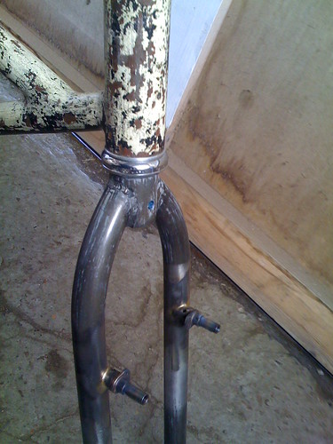

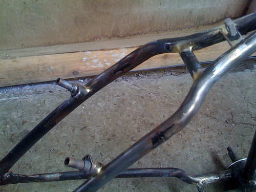

Next port of call was to my good friend Bjorns place. Bjorn builds his own tandem frames and learnt his skills from a chap who lived next door called Dave Yates. His brief was to add canti mounts to frame and newly aquired 26" BMX forks and to replace the original seat and chainstay bridges. The original bridges were made from bent sheet and had cracked in all the usual places. Bjorn also added a bridge for a canti hanger from flat plate which he drilled and tapped. I powdercoated his favourite tandem frame (30,000km and still going strong!) in exchange for his brazing work which is much better than my brazing it must be said!
I have just collected the frame and its now time to start building it up. Watch this space; no doubt its going to be another epic :roll:
Some pics of Bjorn's handywork
