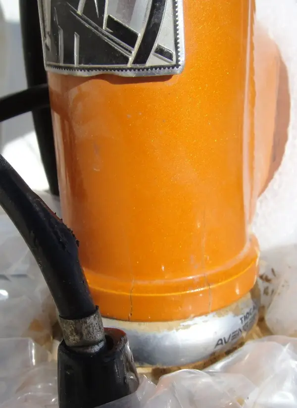

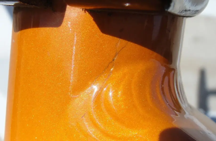

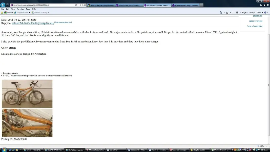

I bought this thru craigslist halfway across the U.S., and the seller agreed to ship it to me. Attached is a screenshot of the auction (I cut the seller's phone number out of the pic).
I phoned him. I didn't bother to explain to him that the swing arm is steel and the main frame is aluminum, but I would have if he had mentioned it. He said he was the original owner.
Based on his description and after speaking with him, I assumed he was sure that the bike was in good condition. I am now kicking myself because I should have asked him specifically to look at the head tube and the seat tube area for cracks. I have always asked this of every single other aluminum Nishiki bike that I was interested in before I commit to buy or to drive very far to see, but I ASSUMED he knew what he was talking about. Live & Learn, right? I was so excited to have found one of these bikes that I didn't do my due diligence and ask the right questions.
Personally, I find it hard to believe that the seller didn't notice the cracks, because it was the first thing I looked for when I received it, but I guess it's possible, although I'm wondering if he saw them and didn't think it was a big deal. Before I call the seller to ask him about it, I was hoping that the retrobike community might have some input as to whether or not this frame is salvageable.
I'm sure whatever fix that could be provided would be quite noticeable. Perhaps some outer "sleeves"; one welded to the top of the head tube and the other welded to the bottom, and perhaps another sleeve around the seat tube? Appearances aside, could this frame be once again safe to ride, and would it be worth the time and effort?
Thanks very much in advance to all of you.

They can be fixed by a good framebuilder, but will require stripping the paint in the cracked areas. I'd have it stripped completely and repainted afterwards.
Thanks, that's reassuring.
I'll have it sandblasted before I take it to a framebuilder. I think I can have an auto paint store match the paint, and I can spray it myself.
Anyone know of a good framebuilder in SoCal that works with aluminum?
alu
i am not so sure , it,s a 20 year old alu frame.the heat on the new welded area,s will make the old tubes weeker . i am not sure i would want to ride it ,it looks like the whole front end might snap off any time :cry:
He's actually written in his ad that there are no" dents or defects".
They are pretty big defects so i thinks you should get back to him & get a refund or at least some money off towards the repair.
I'd say as the advert said no major defects, whilst there may he a debate as to what constitutes major, cracks in the frame wherever they are, should be considered structural issues worthy of mentioning, and its not as though they are invisible, small is it.

As for the repair, has anyone ever repaired an aluminum Nishiki frame that's this damaged? Any before and after pics? I've seen pics of Arran's FS3, but none before the repair was made.
Thanks again to all.

I'm still hoping someone out there knows of a frame that's been damaged this much that has been repaired. Anyone?
Someone (arran?) On here hash the very same frame repaired. Might be worth contacting him about his repair? I still think you are beating yourself up a bit about trusting someone's description/honesty. If only all sellers were honest, if they were you would not be in this situation, or would be, but knowingly.
Update: I emailed seller and sent him the same pics I posted here.
His response: "The bike was perfect condition prior to packaging, and the bike shop will confirm this." so I can only assume that the delivery truck driver stopped somewhere along the way, unpacked the bike and rode some gnarly trails with steep jumps and drops, and eventually crashed it into a tree, and then boxed it back up and delivered it to me. That's the ONLY possible explanation for the cracks. :shock:
So, the seller saw the pics and is telling me they weren't there when he shipped the bike. He wouldn't LIE to me, would he? :wink: Either that or he doesn't know what he's talking about and is too stubborn to admit he might be wrong. So, according to him, he's "perfect", so he's not to blame. Yeah right, and I'm sure he wears a halo and his poop doesn't stink either.
If I want to collect insurance, I'll need to prove the seller's claim that it was in "perfect condition", but I neglected to have him send me closeup photos before making the decision to buy, so it looks like I'll be chalking this one up as a lesson learned.
