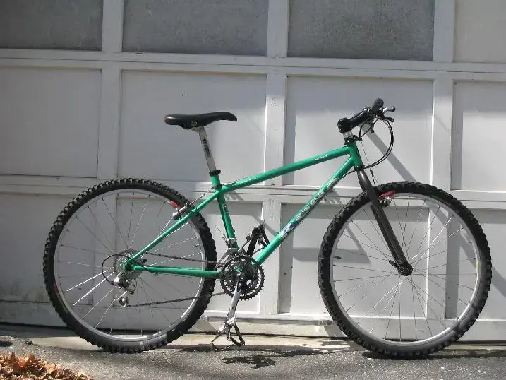

Everybody has seen pics of the multi-coloured Hots many times, so I’ll show you the nicest pic I have of a Teesdale Hot and Mr Zero’s portrait of his 98 Hot. I know Mr Zero was uncertain as to the authenticity of this frame, but I believe it is genuine and very handsome, although obviously it differs visibly from a 98 Explosif only in details. Don’t worry if you can’t see any magic - after all, magic is invisible.
