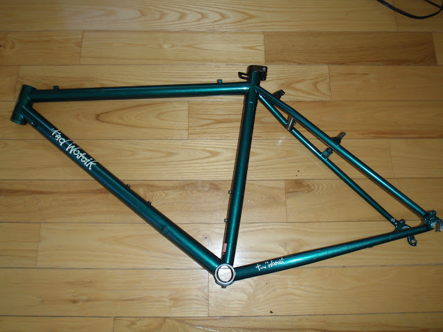

This is a bike I've had for a number of years and brought back from the dead. The frame was a $65 ebay find, and with some love, care and building and re-building, I'm finally happy with the build. It was complete re-finish, and a terrible hunt to find a suitable fillet brazed steel fork to match the character of the frame.
It's also worth noting that the 67-Degree head angle makes this an INSANE descender!
Frame: Ted Wojcik Fillet Brazed - Builder's Personal Bike.
Fillet Brazed Logic Prestige tubing - considered nearly impossible, as Logic Prestige was specified as TIG Weld-only!.
Fork: Fillet Brazed Straigh Blade Cromoly
