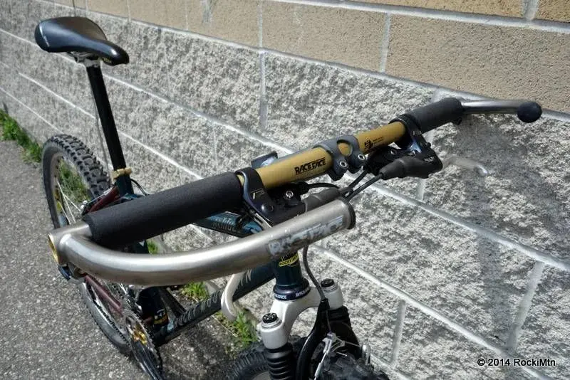

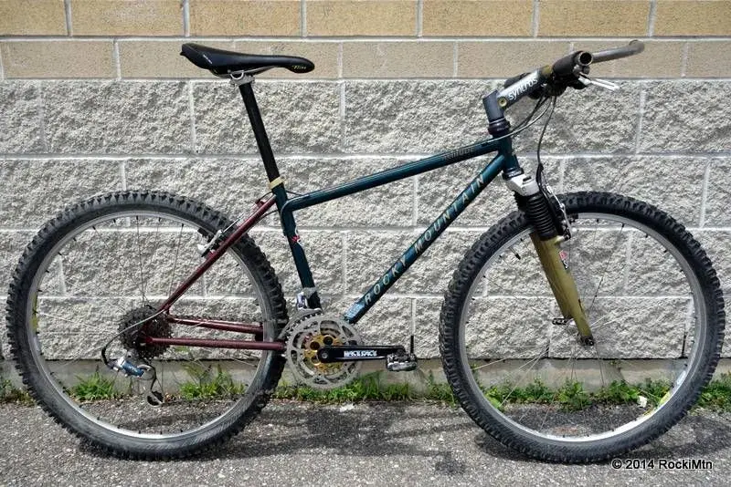

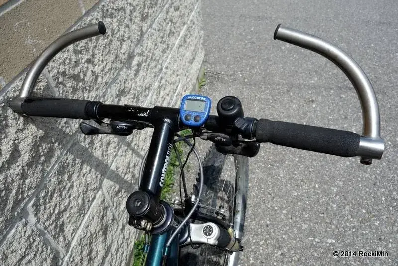

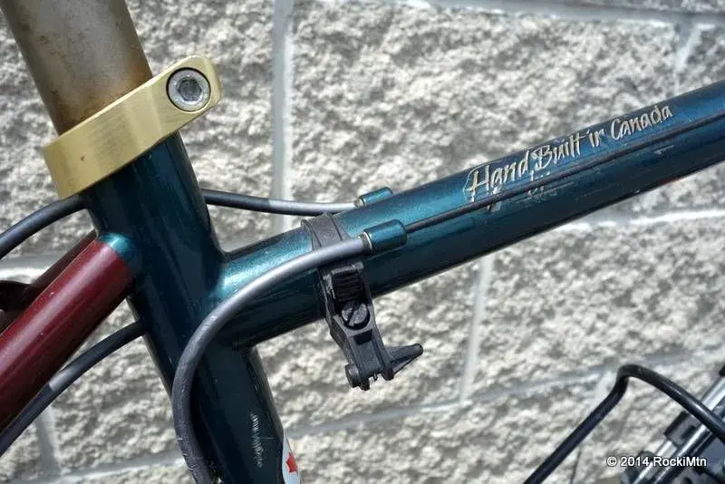

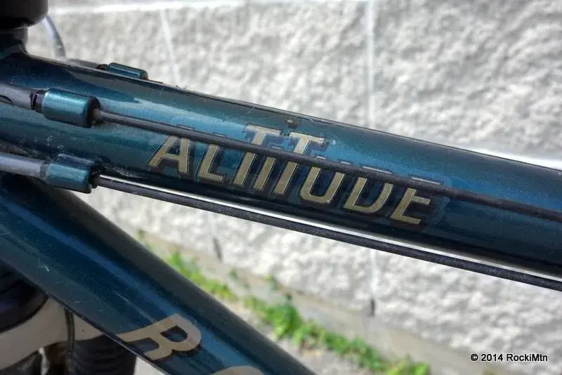

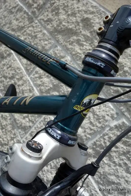

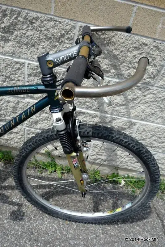

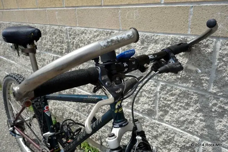

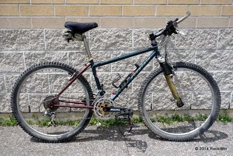

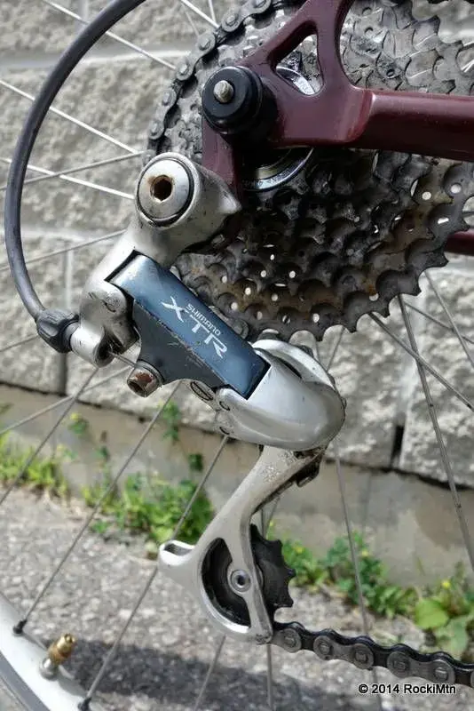

in time for Canada's Day celebration tomorrow, i just got back from a 4 hour round trip to pick this up from a shiate shack in literally the M-F-N! this is "as is" as i was presented with it locked with a link chain and padlock in a junk yard style garage shed. :shock:

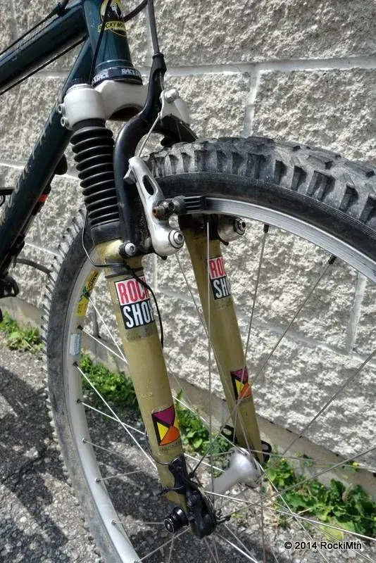

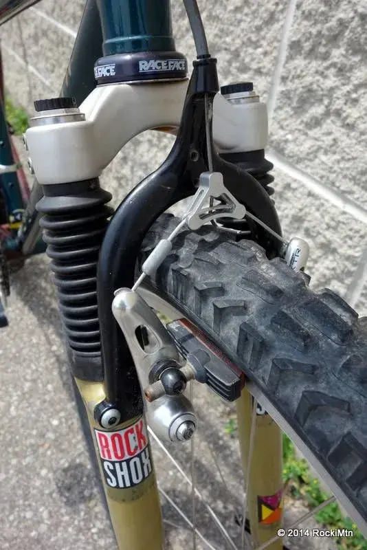

needs some TLC and parts swapped but all in all it's in fairly good shape, and with the majority of it's original components i think. pump up the tyres with air and adjusted the saddle height and it rode quite nice. the mag21 are holding air and seem to be functioning as should even!

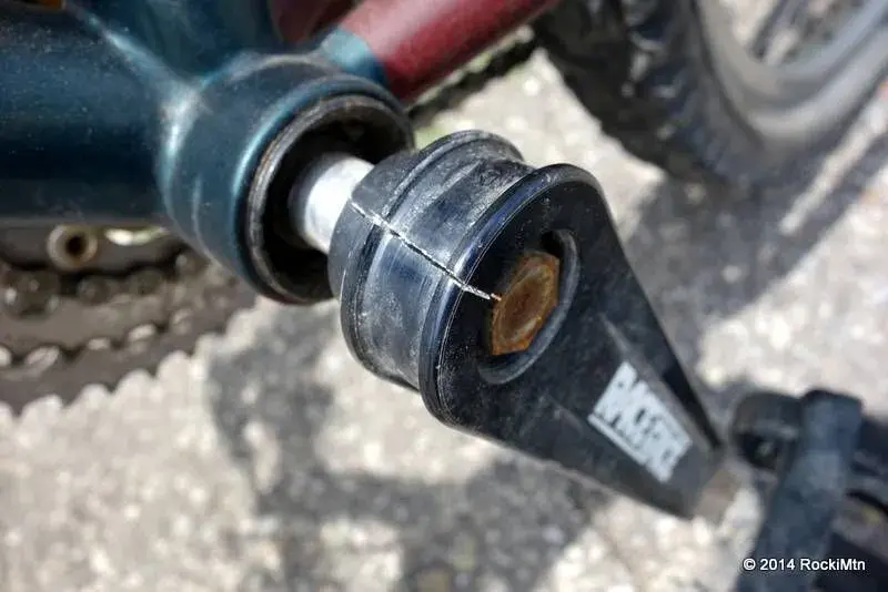

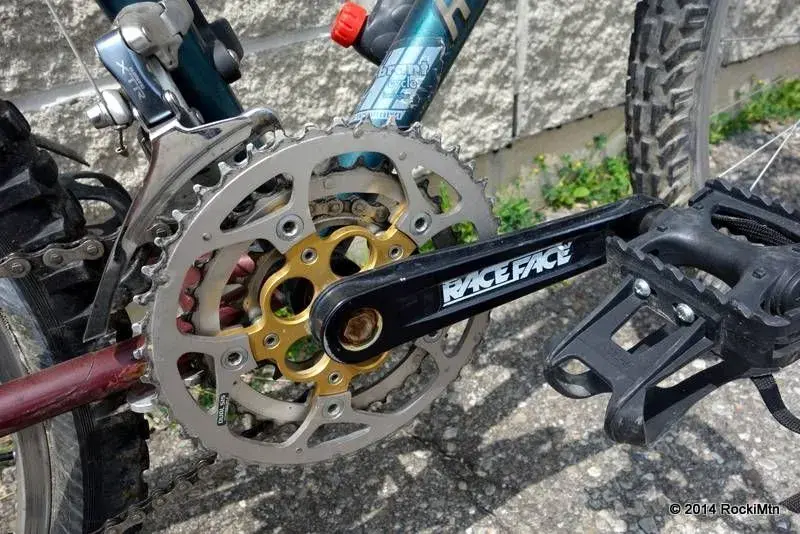

only bummer was the cracked non-drive side RF arm. :( was one of the highlights i saw on it, but i managed to get $100 knocked off the asking price. and luckily i have a replacement, albeit not as nice looking cosmetically.

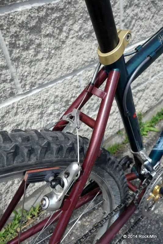

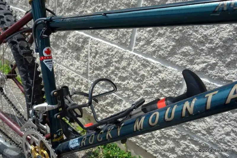

need to good clean and strip down, particularily all three of the bike pump mounts on the darn thing. :roll: 🤦 i think i have most if not all of the replacement parts i want already in possession… RF IB cranks, RF ti EX stem, gold ano RF bar, Syncros ti seatpost, Flite kevlar saddle, and a pair of Shimano XT m737 SPD pedals.

build spec:
Frame: 1993 Rocky Mountain Altitude
Fork: RockShox Mag 21
Headset: RaceFace
Stem: Syncros Cattlehead
Handlebar: Syncros
Grips: ODI Attack
Barends: RaceFace Titanium
Brake Levers/Shifters: XTR M900
Brakes: XTR M900
Brake Pads: XTR M900
Brake Cables: XTR
Cantilever Cable Hangers: Avid TriDangle
Front Derailleur: XT m900
Rear Derailleur: XT m900
Cranks: RaceFace Turbine IB
Pedals: XT m737 SPD
Chainrings: Shimano SG-X
Bottom Bracket: RaceFace
Cassette: XTR M900
Chain: KMC X8
Hubs: XTR M900
Hub Skewers: XTR M900
Rims: Mavic M231
Tyres: Ritchey Megabite Z WCS
Saddle: Vetta SL Titanium
Seatpost: Syncros

too bad about the crank arm though.

The frames quite tidy, are you going to sketch up the decals. Hint hint.

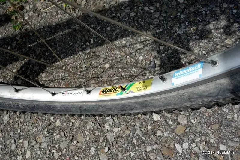

Hows the front rim as being 28 hole is a bugger to replace.

Nice! The gold accents on the bike look great, and the Raceface bar will go nicely with it.

didn't do a hole count on the front. will have to check on that, rims look to have fair amount of use, but still going strong so should give me still many good years.

it would have been even nicer if the crank wasn't cracked, and it had the full syncros stem/bar/seatpost treatment. but i can't complain much! ;)
okay, first round of my typical many changes! :lol: gave it a decent cleaning, and removing all the "extra" stuff i didn't want/need on the bike. original seatpost and stem plans didn't work out. forgot this was a 27.2, and the ti post i have is a 27.0. good thing i had a spare black 27.2. ;) the RF ti stem was more work to convert the steerer setup than i wanted to tackle at the moment, plus it was zero rise which i wasn't sure would be comfortable. so instead i went with a grey Syncros cattlehead. would have preferred black perhaps, but i didn't have one and this doesn't look too bad.

decided to just throw on the non-drive crank, and leave the drive side at the moment. the replacement crank has 48t outer and i would have to re-align the front mech, as the current one is 46t and i didn't really want to as it would leave and make new marks. :?
switched the front tyre around so the rim decals matched, and while i was at it, also changed both inner tubes since i found the front had 6 patches in it. :roll:
