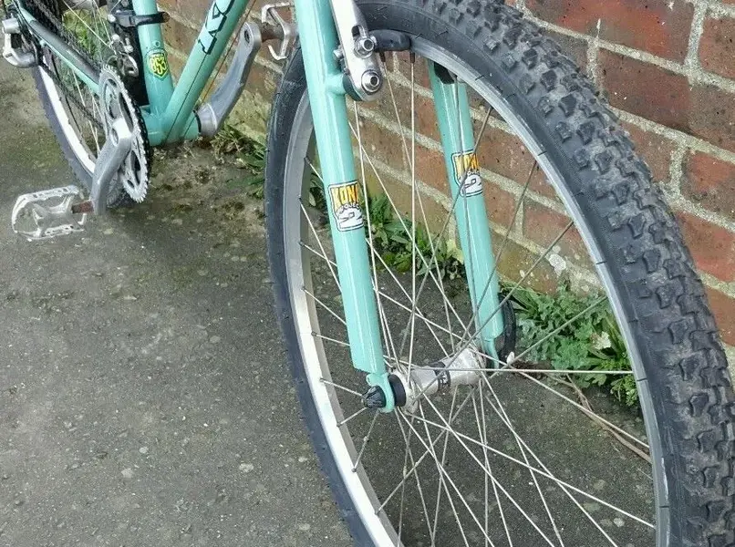

It's back again, and with the same somewhat inaccurate description - The Project Two forks seen here are not the original pair that would have been fitted. :roll:
Collection only from Bognor Regis with £150 start.
http://www.ebay.co.uk/itm/Kona-Kilauea- ... 1968149867?
Pip

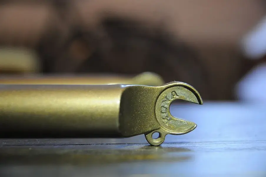

haggis":2jn7921r said:
How can you tell its not the triple butted P2s?
Plain gauge and Triple Butted have different welded Dropouts - regardless of them being Spinner or Kona.
Plain Gauge:
Triple Butted:
e-Bay:
Pip

I just got back from Bognor, lovely day at the seaside :lol:
Did a deal for £100.
My guess is he did the paint job and the decals are just stickers, possibly an inkjet printer job!

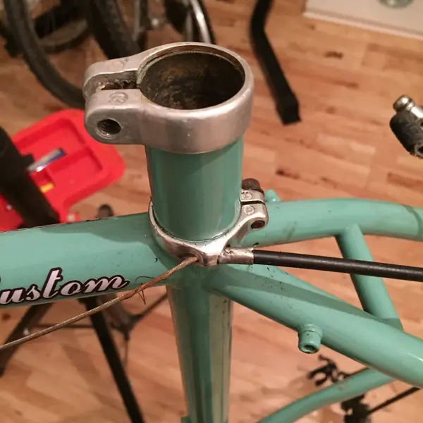

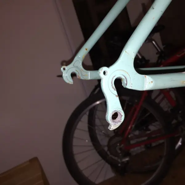

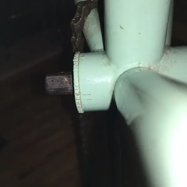

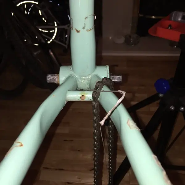

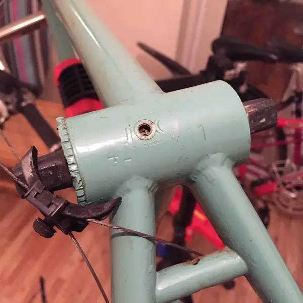

He said he bought it off his mate for £600 and his mate bought it for £2000 and it had Marzocci forks. Apparently was pink originally.
If any of you can help identify it that'd be much appreciated. Only numbers I can see are 4I-11 on the bottom of the BB shell and BI 0569 on the top.

I'd get some paint thinners and try to rub some of that green paint off to see whats underneath. It might give a better clue to it's real identity.
