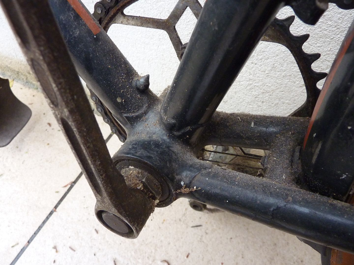

needle bearings bottom bracket ( still to be undone and cleaned)

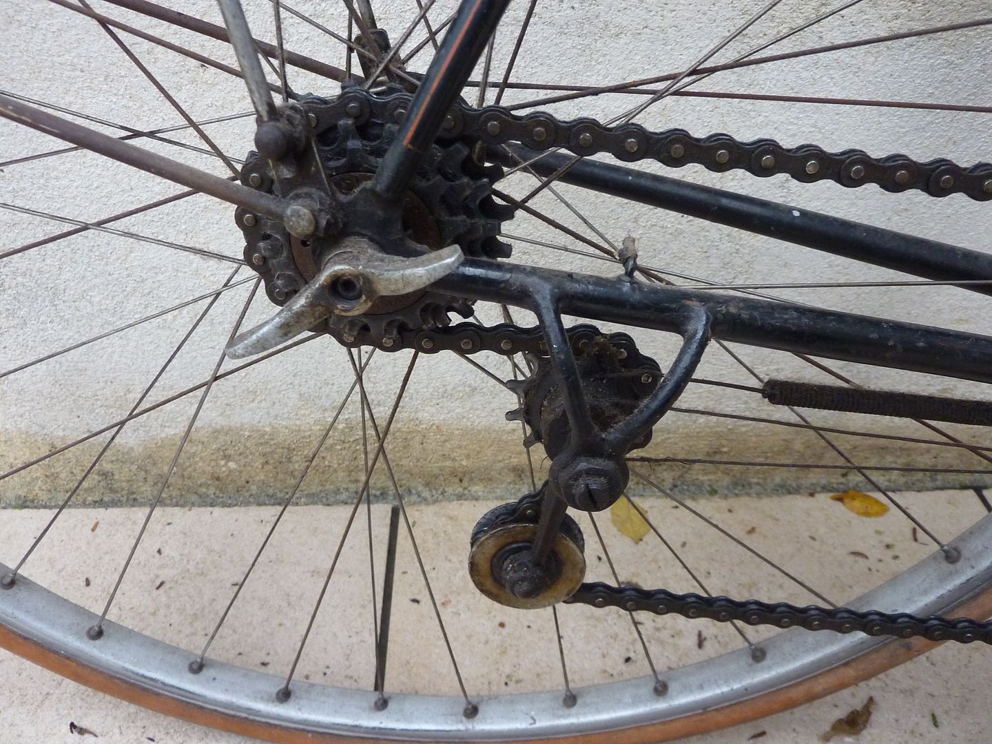

One thing I probably won’t be able to do is find the missing front derailleur. At that time, it was common for these to be custom made by the builder but no pics is available to help me in that regard.

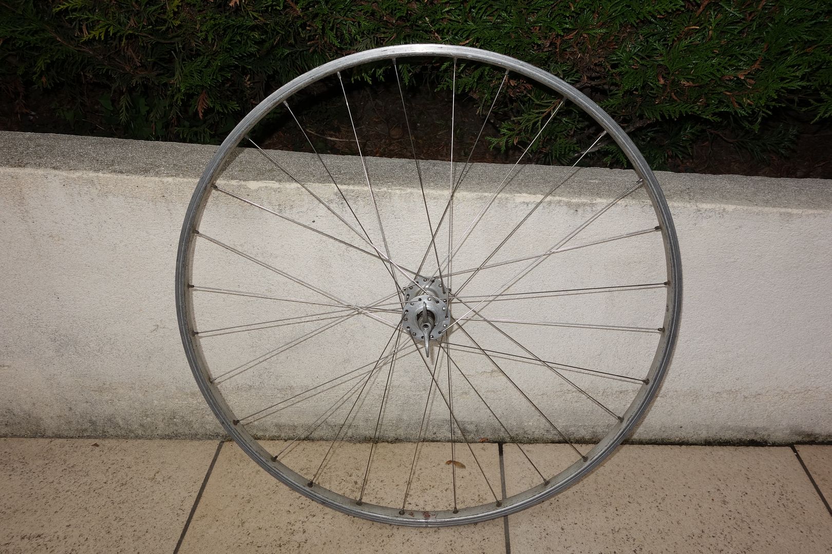

The wheels

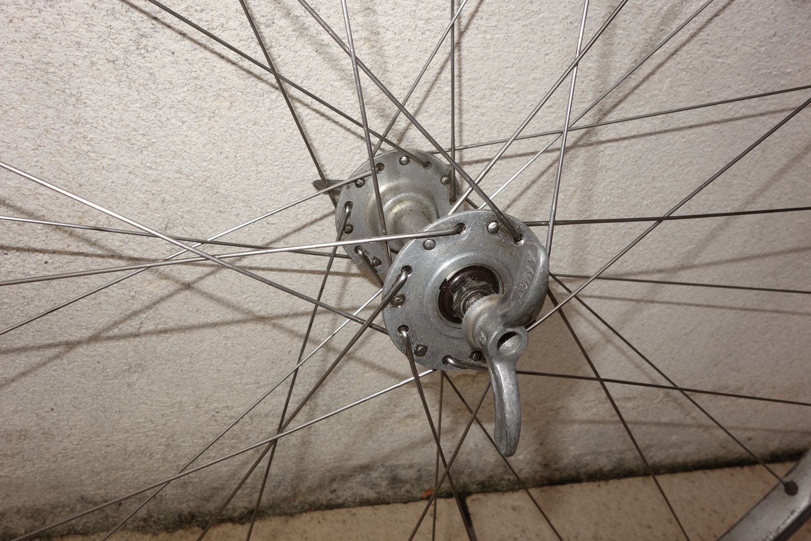

CAR was actually a French make , from the Ripet company in Saint Etienne - builder of hubs and cranksets and one of the first builder of annular bearings hubs.
It sold possibly end of 1938 to the MAXI company, who did make usual cones and balls hubs. and became the pretty weel known Maxi-Car make.
The pair of hubs is unusual as it sports not the usual screwed side covers seen on later post war maxi car hubs. There is just an open ring to block it. These hubs are just amazing; I have done nothing to them and they are still buttery.
The rims are most probably MAVIC Dura rims mounted on all the prewar high end machines. The front rim is very unusual at 28 spokes. The wheel weighs 770g ! quite an achievement at that time.
The spokes are as startling and awesome. These are 3 stars Robergel stainless steel butted spokes of 1.8/1.5 mm. They are so flexible and durable I am still amazed. I had just to clean these with triple 000 wool.
Some of these had been changed to cheaper ones which rusted, so I had to kidnap some rear wheel ones to rebuild the front wheel and unfortunately will have to relace the rear with new DT ones ( robergel are unfortunately as rare as a hen’s teeth !) and alas , the DT revolution 2/1.5 don’t come in the 302mm length so I have to settle on DT Competition.

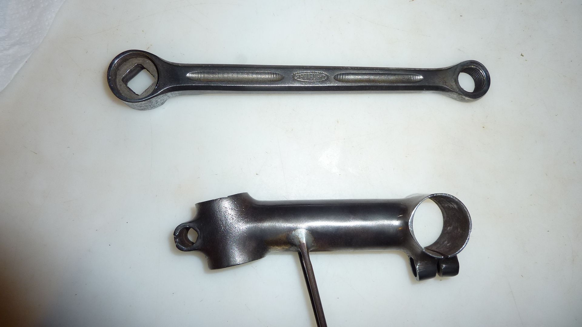

Crankset : it is a stronglight which apparently was presented at the “salon du cycle” in 1937
Courtesy of "Velocifer"
https://www.flickr.com/photos/velocifer/

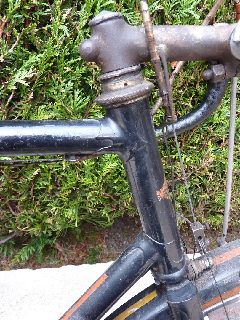

Stem is quite unusual and possibly one of the first ahead stem. You see similar stems on French bicycle of the era or later
Il weighs165 g

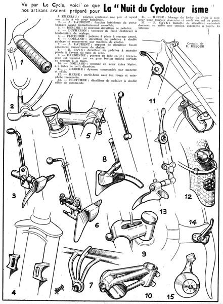

Here a 1948 Rebour page of sketches

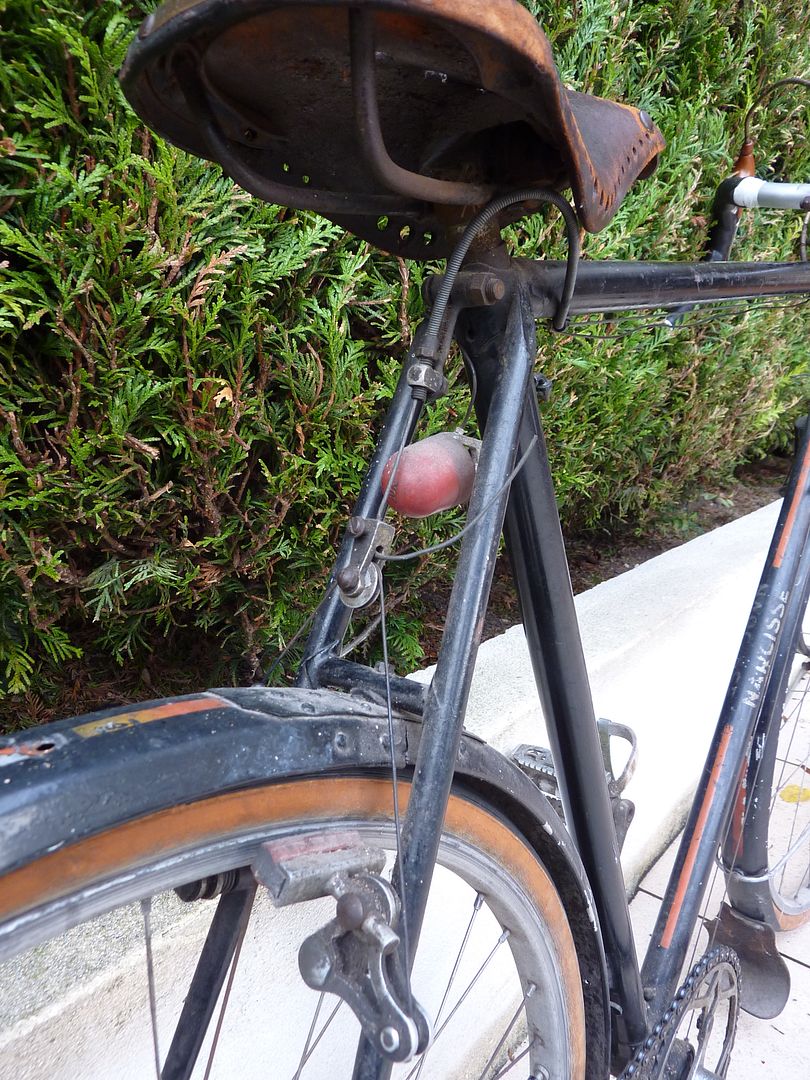

Brakes are Speedy
Apparently these speedy brakes are an evolution of the first cantilever brakes attributed to the French builder Barra. Supposedly In 1936.
They evolved later on to the specific Herse cantilevers. By the way Herse apparently did a stint at Narcisse learning the tools of the trade before starting his own venture in 1939/1940.
