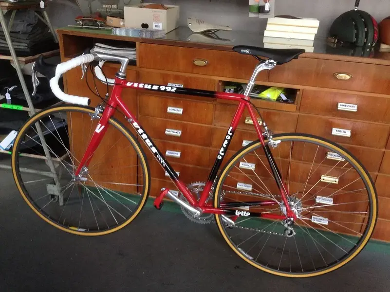

here just finished from work shop added to my collection – my 1995 Lotto Vitus 992
Loving this beautiful fork and steering tube combination I had looking for more than 2 years to find a frame set in really bad conditions – After professional repainting and special support of DB of http://www.wanit.co.uk (Many thanks to DB - he makes individually for me the decal set for Lotto Vitus 992 Ovoid - great work)
The Team of 1995 has equipped the frame set with a full 8-speed Campagnolo Record group with Ergopowers 2nd Generation and a Cinelli cockpit. At least the unusual saddle SL from Vetta and classic tubular wheels of Campagnolo.
Technical Specifications of 1995 Lotto Vitus 992 Ovoid
Frame set Vitus 992 Ovoid, size 54 cm, Aluminium
steering Vitus origin
bar Cinelli Giro d‘Italia
stem Cinelli XA
bar tape Cinelli cork white
seatpost Vitus
Saddle Vetta SL
Bottle cage TA Specialites, black
pedals Look PP396 ARC
Group
breaking/shifting Campagnolo Ergopower 8-speed
breaking callipers Campagnolo Record Dual Privot
crank set Campagnolo Record 172,5, 53/39z
Botttom bracket Campagnolo Record Vierkant, ITA
front derailleur Campagnolo Record
rear derailleur Campagnolo Record 8-speed
wheel set
hubs Campagnolo C-Record / Campagnolo Record 8-Speed
rims Campagnolo Omega 19 tubular
spokes DT Swiss
tires Vittoria Corsa CS tubular (Retro)
weight (total) 9,7 kgs
base project before restorated
frame set after professional repainting

Very classy bike ! 8)
Why can't I have a loft like that? Mine's full of bits of wood holding the roof up!
Let me know what I owe you for the stickers T :wink:
Mike
Le Rouge et la Noir... hümi, the stem-HB combo makes it very aggressive as well. :)
Congratz, I bet it's a top-notch ride!
