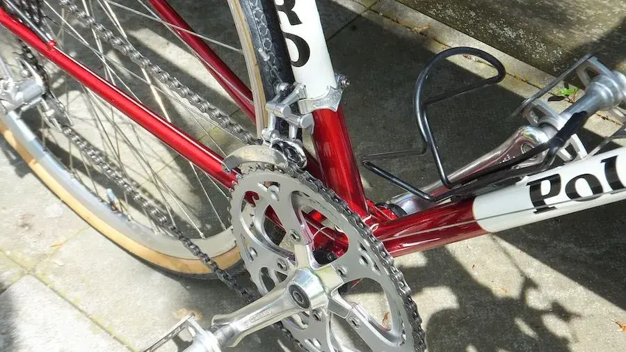

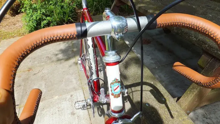

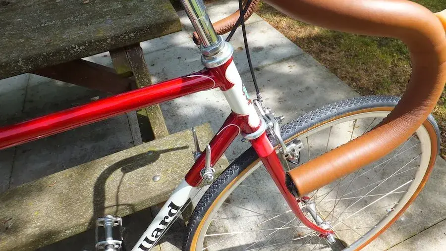

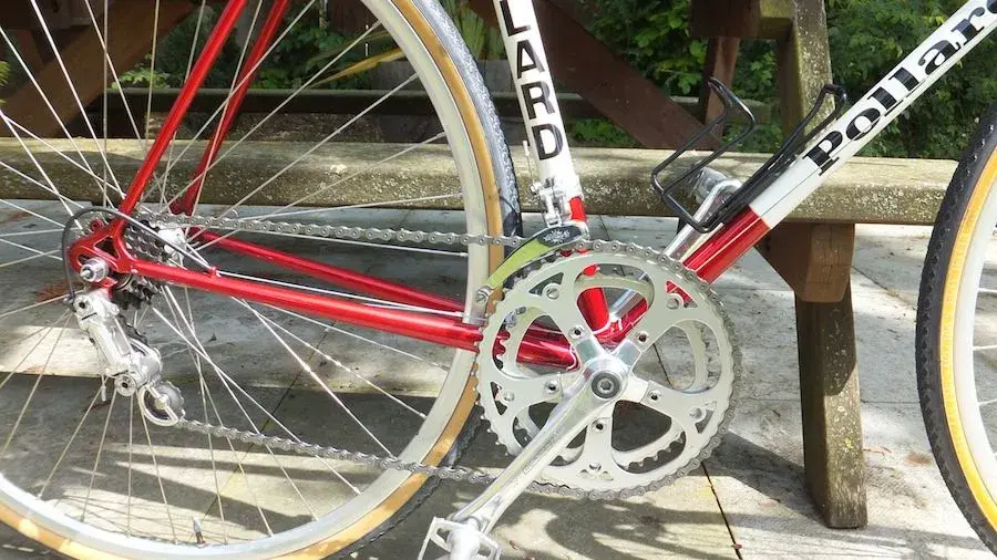

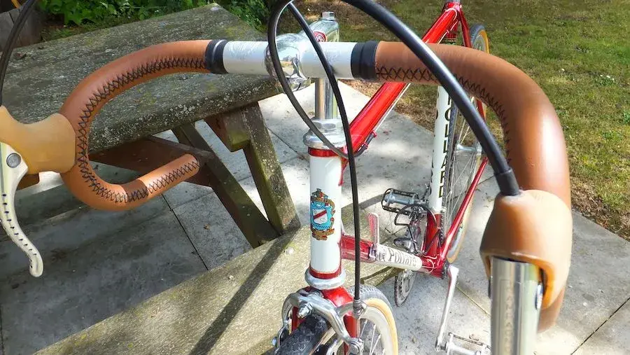

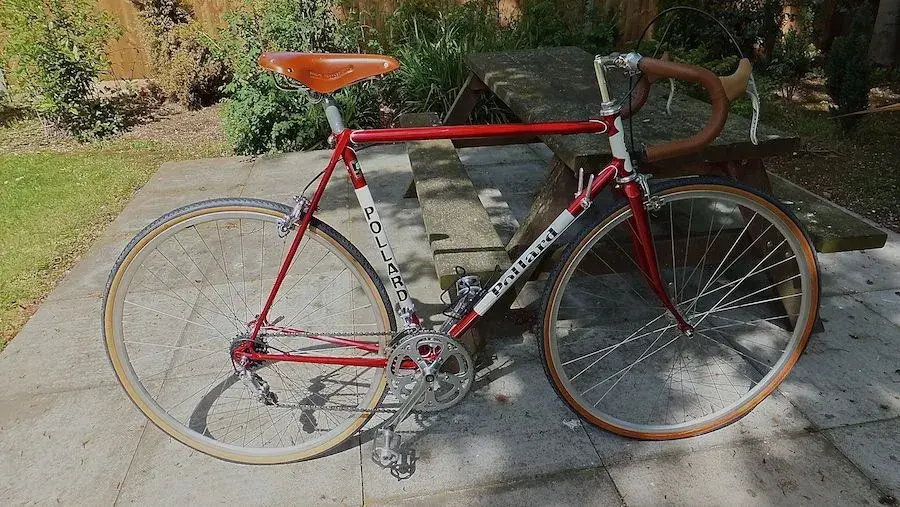

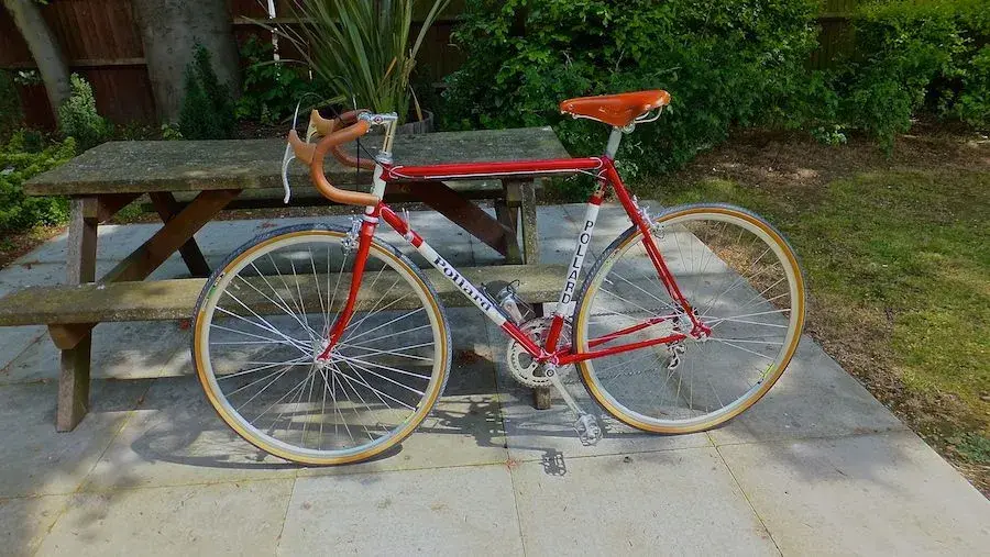

Presenting my Pollard - Reynolds 531. This frame was resprayed in the original colours 20 years ago by Pollard and was, I'm told, hardly ridden from that day to this. Bought it a few months back as it looked brilliant. However, I've done a bit of soft restoration on it.
The bottom bracket, headset, cranks, rear derailleur, saddle, brake cables, stem, handlebars have all been replaced and on a whim decided to stitch the handlebars in leather wrap.
Anyway, don't see many Pollards around - I'm told the frame would have been supplied to Pollard by Holdsworth, as it's pretty much the same frame as my Super Mistral.

Now that's such a nice machine :)
Looks like late 60's when the trend was for plain Italian style lugs and the fully sloping crown.......plus all the braze ons. :) Forks and stays were as thin as possible with the fork rake starting just a little higher up the blades. Glorious :)
It needs some brakes that work on the other side so the rear brake cable does not cross the frame but that's minor....
Shaun
PS what's the chainset?
Re: My Pollard
The cranks are a Stronglight 52/42. I was going to use a nice Campag I have but the bottom bracket axle was too long and didn't want to bother changing. The Stronglight cranks have a recess inside and so sit further in than the Campags. Not really happy with the rear brake cable, I've shortened it too much I think, so will change that.
However, according to Eddie Pollard (via Roger Langworth at Classiclightweights) this bike is not actually a Pollard at all. It's a Holdsworth which the previous owner, for some reason, had resprayed as a Pollard AT the Pollard shop. Curiously though, it doesn't have a Holdsworth serial number - the BB and the rear dropout are stamped 005. So, I'm really struggling to find out where it came from originally. It is 100% identical to my Holdsworth Super Mistral in everything except the paintjob.

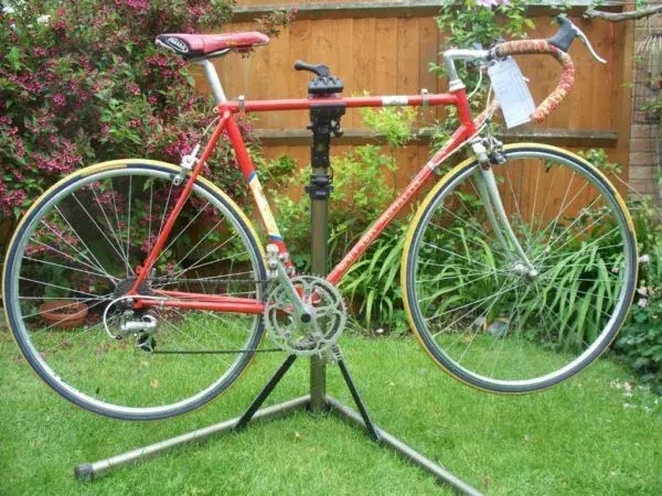

Nice to see a good Pollard on here: )
Here's mine.
Quite an oldie, but the Hellenic stays are quite unusual.
Top Coventry builder in the day.
More pics available if asked for: )

Pollard / Holdsworth................. still a classy looking machine, TA cranks would also look the part :)

Didn't like the TA cranks, and they were a shit to remove. I guess it will have to stay as a Pollard/Holdsworth hybrid and if I decide to upgrade the BB I'll fit my campag cranks which are waiting for a project. Can't find anybody at all who can throw any light on the 005 frame number. So I don't really know what it was intended as originally.

A fantastic looking bike - beautiful, even if you are unable to uncover the pedigree (or lack of it :wink: )

Thanks. May have to remain a bit of a mongrel - albeit a classy looking one. Coming by information on some of these old frames that don't have correct frame number type is pretty much impossible.
