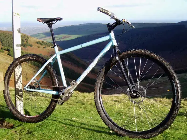

I've still got this one at the minute - probably not for much longer though.
Suitably retro anyway.....

How do you find the Cromotos?

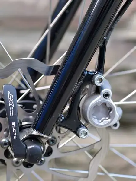

I like them - except for the fact that I couldn't get the 425mm version as disc only, so I had to remove the rim brake mounts and re-touch the paint work. Luckily, as they're just gloss black, that was easy to do.
Even though they're sold as 26" forks the 425mm's have loads of clearance for a 29" wheel and as big as tyre as you would want (I've had a 2.35" Rampage in there with no problem).
Nice stainless dropouts too...
Overall I reckon that my Hummingbird handles that little bit better - I'll drop/roll off stuff on it that I think twice about on the Kona for some reason and on one of my favourite test sections (a 10" deep and very narrow sheep track that drops round a rock outcrop then down into a deep gulley) the 'Bird tracks straight down the centre as if by magic whereas it's a bit of a battle on the Kona to stop it wanting to try and climb the sides of the rut and then tuck the front wheel under (which, at that location, would end in tears...)
It's all down to rake and trail of course - still, I really like the Kona, it's a bit lighter than the 'Bird and it's been a rolling test-bed for all sorts of stuff. The Excentriker BB, disc brake conversion, 29" front wheel......I'll miss it really :cry:
