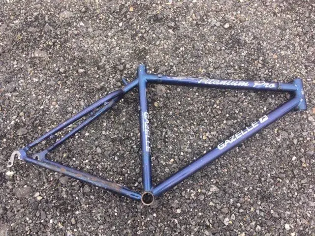

Have just done a deal on a ratty looking 1995 Gazelle Titanium Pro frame. Apparently it's the same frame as the Raleigh MT2000. I'm quite excited having never ridden a TI frame.

Oh and what about taking the paint off this and having it bare titanium. The paint's shot anyway. Nitromors? Or leave alone? Hmmm...

I'd be tempted to out a bit if effort in and remove the paint. You can then decide if you want shiny or Matt style finish and polish accordingly. I've got a few ti frames and never understood why you'd paint one, as bare finish looks great (and saves a few gms). Both my hard tails have pace carbon rigid forks, look and ride well, light too. I have had suspension forks too, but in a frame of that vintage you'd want shorter travel, 80mm max I'd say.
V brakes are always a step forward imho. Touring will be a bit funky on yours due to the cable stops being on the wrong side. It can be done easily enough, or better yet, find a set of brakes where you can swap over the noodle mount (Paul's, avid ultimate, onza are a few options, as are prg which are Paul's copies, I'm lucky enough to have one of each, and have used them to great effect on the same frame you have, well a Raleigh taurus).
Whilst you might want to do a cheap build, a ti frame deserves more, and you'll probably not regret it. Build it with what you can, then upgrade as you grab bargains.

At least not being precious about cosmetics and period correctness means I can go for good bits that work rather than obsessing about getting everything just so. Pace forks would be nice.
I think I will have a go at removing the paint. Will see how much of a fight it's going to give when the frame arrives.
Re: Re:
foz":hlfqbdk4 said:
Driveside chainstay looks rust coloured? Or is it just muck?
Seller's pic - I haven't actually seen it in the flesh. I'm hoping/assuming the latter as there shouldn't be any steel there to rust!

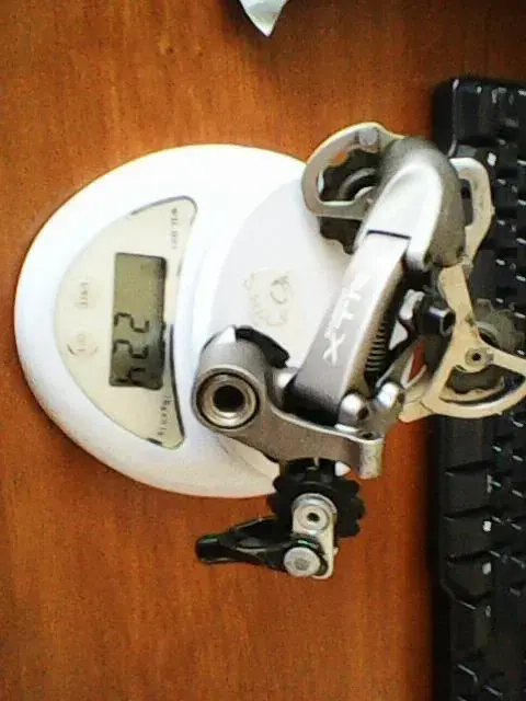

Thank you mr postman. An XTR RD-M951 rear mech. Not minty but feels super-slick in my hands. Non original (Tacx) jockey wheels so it's obviously done a few miles. It's slightly weird being a rapid-rise mech so the shifting is back to front. That'll be a bit of fun. And it looks OK on the scales too.
I thought that too. Could just be from where a rusty chain has sat, but.....
It’s the same frame as the first version of the Raleigh Torus:
Cable guides on side of top tube,
Canti studs,
Cable hanger,
Drops-outs without the hole,
Larger welds than later versions which look like arc welding,
Ribbed single cable guides
Only one drain hole in the BB shell(?)
No extra rivnut above the BB shell.
Think that’s it.
It’ll be fairly roughly blasted underneath the paint I expect.

Frame is just dirty. I know because i sold it. I hope this gets the love it deserves.
