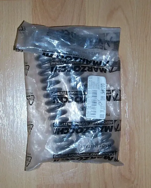

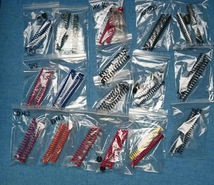

I don't have any special documentation. I found not that much information about. There where different brands (e.g. Reset, RTech and other) and different versions for different riders weight. Some had be coulored, some had caps on one or both sites, some cames without.
I have collected a box of it.
