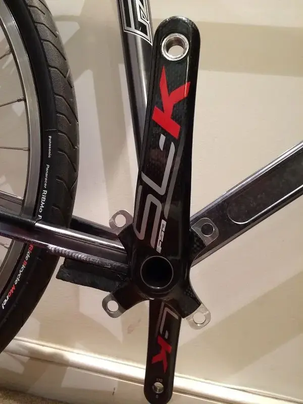

Have decided that it would be a sacrilege to get rid of these gorgeous carbon SL-K cranks, installed with their crank specific BB

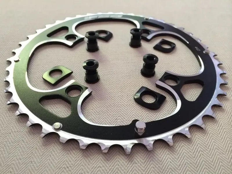

SL-K chain ring ready to fit along with a new set of Race Face alloy chainring bolts and a set of the brilliant Race Face blanking plates for the back of the cranks to leave a nice clean finish.
