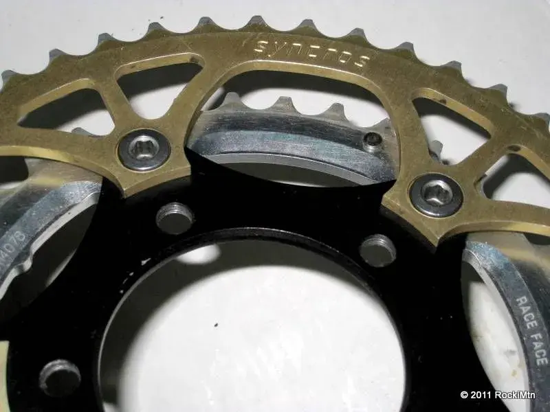

I've got a set of Syncros Revolutions (standard not compact set). However the spider that came with it isn't like most that I've seen posted where they require a special two piece bolt set to attach the spider and inner ring to the arms. Instead the spider holes are threaded and I can use standard inner chainring bolt and spacer to fit the it and the inner ring.

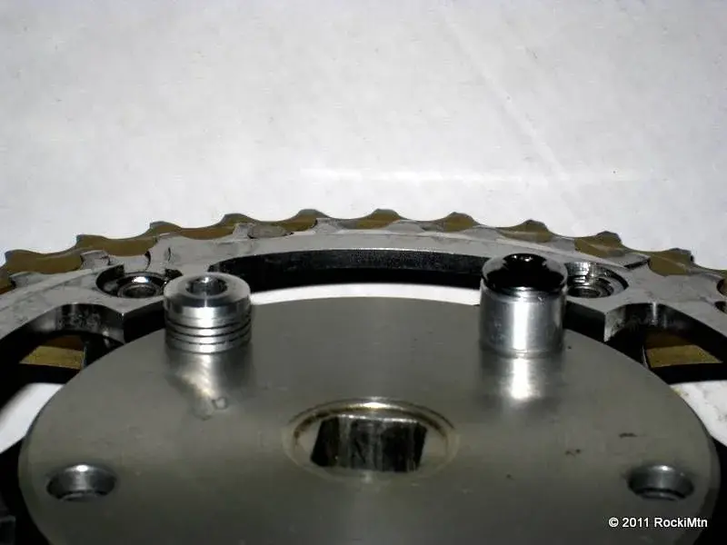

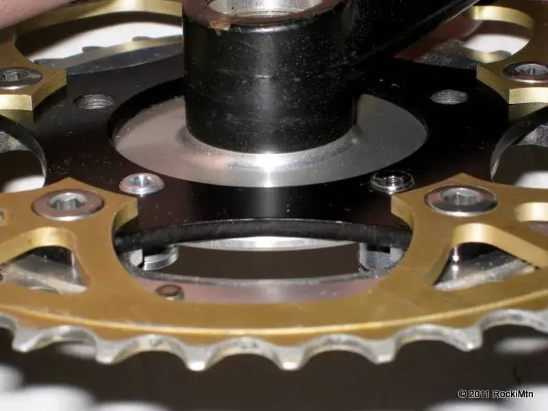

Problem is that I don't have the original/proper bolt/spacers and the ones I do have are either too short or too long. Shimano 5.3mm spacers/bolts has the inner ring too close and some RaceFace Turbine 8.3mm spacers/bolts pushes the ring out too far.
So I'm "guessing" that it's somewhere inbetween at approx 6.6-6.8mm, but can anyone confirm what it should be exactly? Also from what I see available on the web, closest thing I could find was 7.1mm from Wheels Manufacturing. Should I try that or I should I put two sizes on to make up what I need???
