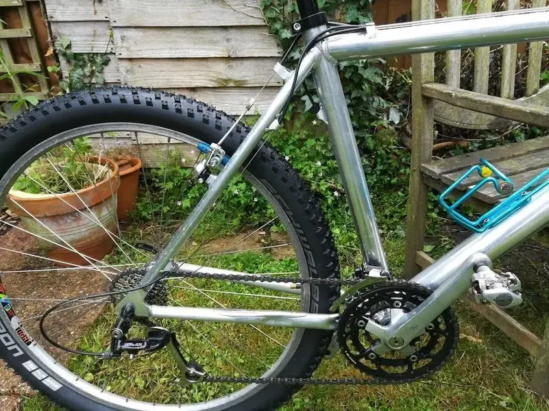

Mystery aluminmiumuimium frame
legrandefromage
Bin Monkey
BoTM Winner
PoTM Winner
GT Fan
Its light
Its a 1 1/4 head tube
Its anodized
Its a 73mm BB shell
Its a 30.9 seat tube
Its for cantilevers
It has a groove in the down tube.
It was a freebie at Mayhem - Thank you!!

Groovy 8)
1"1/4 generally points towards early 1990's doesn't it?

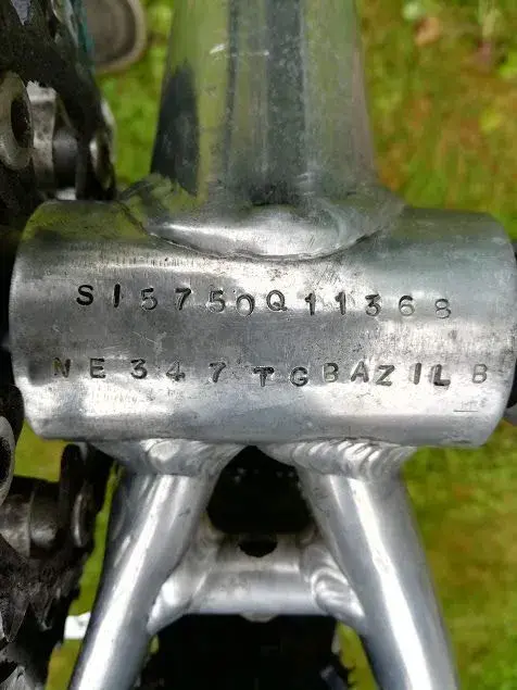

Any other marks or numbers on the frame?

Heres the numbers, and more numbers, consonant, vowel please, then a consonant

The oversized seat tube wasnt that common in the early 1990's as it would have required a funky top pull mech or a roller and a fat front mech. M900 XTR came in the right shape at 34.9mm but I dont think M730 had anything at the time. 560 LX had 34.9 top pull mechs with conventional swing but not until a bit later
I've a feeling its as late as 1994
'NE34 7TG' is South Shields
Maybe a Taiwanese Alfton frame. Looks very similar to my '93 Wheeler 9900. Also 1.1/4 inch but with 31.6 post and a few other small differences. Every brand ordered the frames their way.
