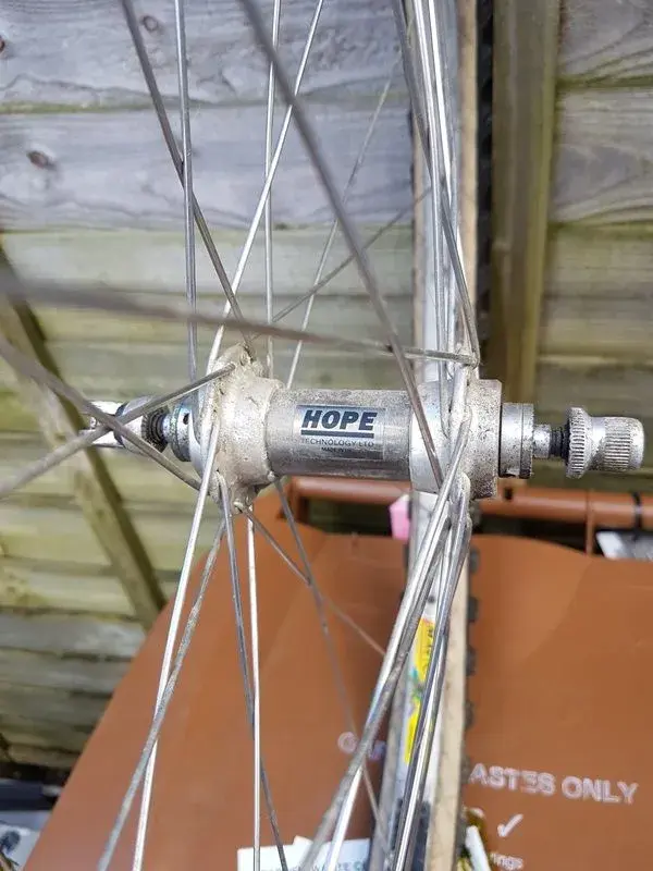

1- Hope hubbed wheels. I know that bit but what model are they? The rear obviously has a non hyperglide free hub as the cassette looks to be a screw on job so guess that marks them out as early?

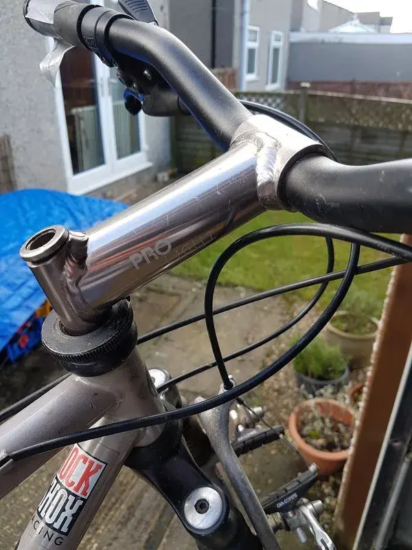

2- 3ttt Pro Light stem. Am aware of the brand but that's about it. The previous owner has shoe horned in a riser bar so is it worth rescuing?

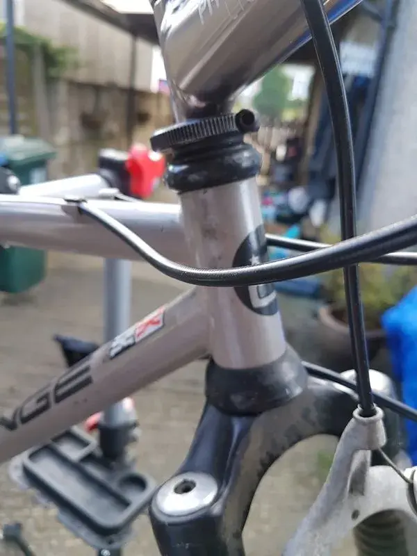

3-Impact headset. These were Dia Comp headsets right? It's got a weird lock ring and rubber covered lower cup. I remember them being often spoken about bitd but can't remember why?

impact headset is a kona part. They have a pretty low stack height, especially the top part, so i'd keep hold of it if you want to use that fork with that frame again
Front hub is a suspension
The thinner centre was the original no name, then came the suspension and then the fatso...
I know this because apart from catalogues I bought one from stif at bike95....
That's and early version of the suspension probably one of he first as they moved to the push on o-rings style pretty fast and lost the ever falling out grub screw.
The screw on rear actually lasted till the end pretty much.
3ttt pro light stem, exactly what it says, obviously the well known brand. I've got a 1 1/4 one of these at home & it is pretty light. not sure how good they are but mines 25+ years old & still intact, pretty sure they did a ti one called super light
Ta all. The Hope will be going a 92/3 era bike so all is well. Seem to remember the early hubs having issues with cracking but these seem fine so bonus. 8)
The screw-on rear is a bit of a classic (for me at least) as you can reverse the axle and make a nice singlespeed hub!
Definitely the thin front hubs (original and lightweight) can suffer cracking. I suspect that many of them got built into trick wheels with funny lacing which over-stressed them.
