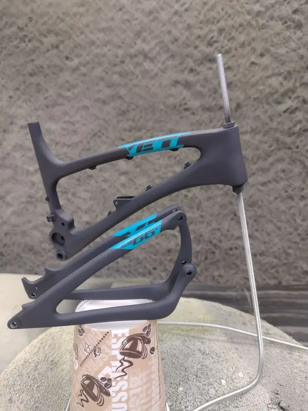

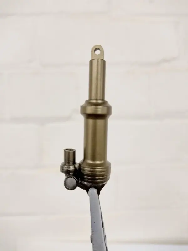

Getting the turquoise right took a bit of mixing. I think this was about the third or fourth attempt.

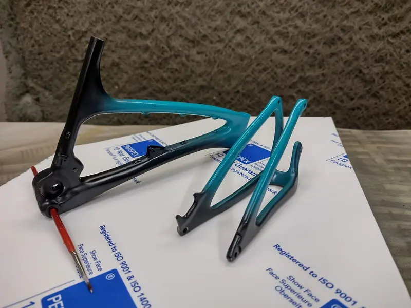

Masking tape and lasers took care of the frame graphics. Waterslides would probably have looked a bit stickerish.

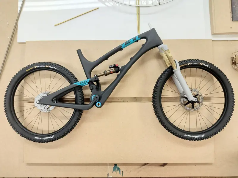

It's always a nerve-wracking moment unmaksing. Happy with the result.

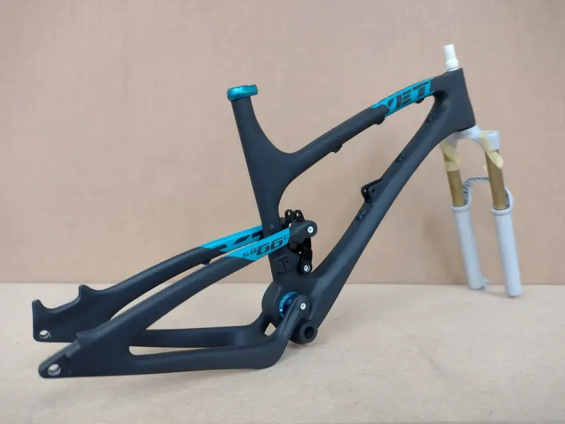

Again with the temptation of dry assembly.
