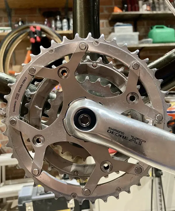

If you really want to stay with the traditional style, then go M953. They're decent mechs, will fit in perfectly with M950 cranks and colours of the groupset.
So yes like the picture you posted.

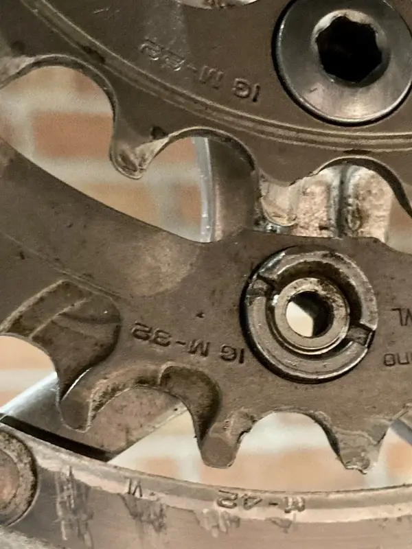

Are you running the cranks in the pic or a different set? I ask only as the m95x range was really designed around a 46 or 48t large chain ring. That said, I've run m953 mechs with 44t rings with no issues and shifting was fine.
Personally I think the m95x, well more m952/3 so much nicer than m900 or m950, so a great choice for your build imho.
