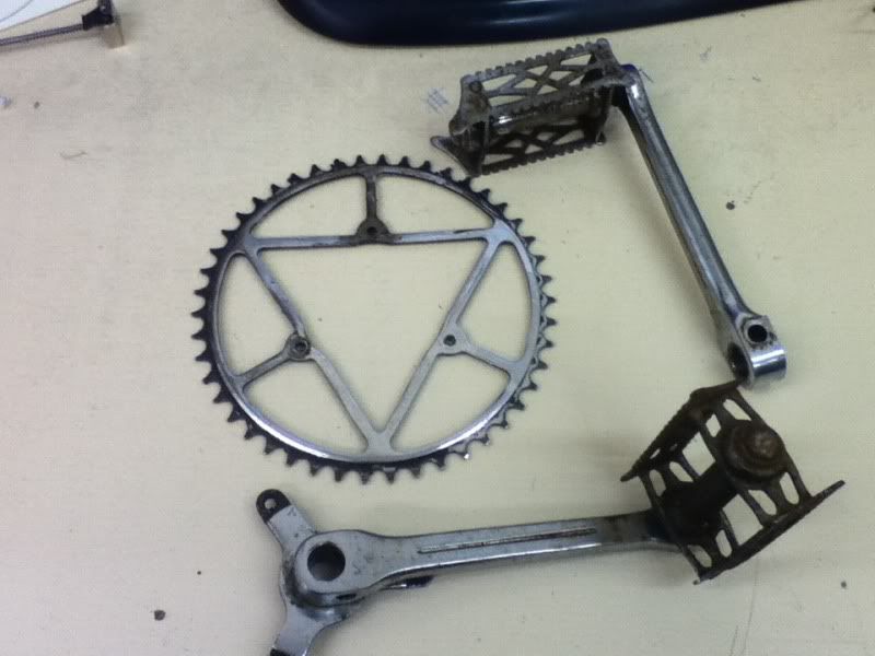

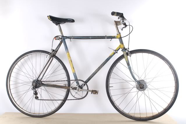

just removed the chain set off my Royal Enfield
an i thought it was a William's

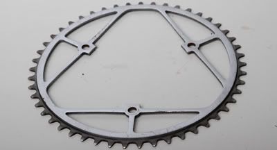

its a 3 bolt, exactly the same as this one
i believe mine is a C1200?
judging on this picture

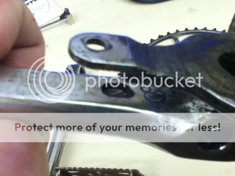

mine looks identical
but i cant find any stamps on the arms to say its a Williams?

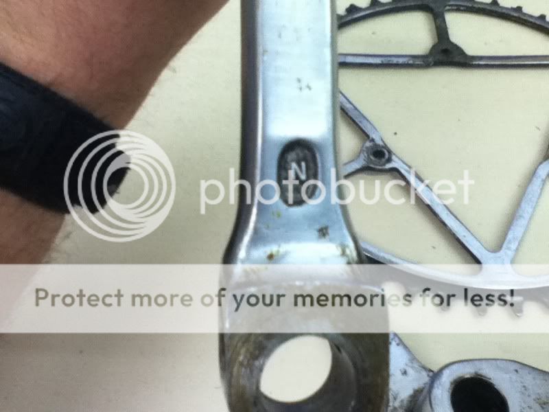

Isn't the "N" for Nicklin ?
The Williams arms had raised bosses so that the chainrings stayed in place and didn't slide about without the bolts. The idea being that it was stronger.

You're right Shaun.
Nicklin.
Williams as far as I know were always marked and dated clearly - at least mine are.

Hi. On the I phone so not typing well. Looking at cycling mag 29.7.1978 and there is an advert for Nicklin chainsets by E Nicklin and sons ltd, willenhall, west midlands. Tel 0902 65451. The pic looks a dead ringer for a Williams

Trying to think back to the old day's I am sure that some of the cranks and chainrings were interchangable between Williams and Nicklin.
I am sure a lot of people thought that Nicklin was a Williams brand name........rather like Ultegra is a Shimano brand name.

MudCow, it looks like a C1200 ring, the cranks would be slim solid forged, the arms in one piece with the crank, wheras the nicklin and most other Williams were "joggled", the crank arms pressed on the crank after plating. The chainring shape was to enable removal over the pedal with toeclip.
