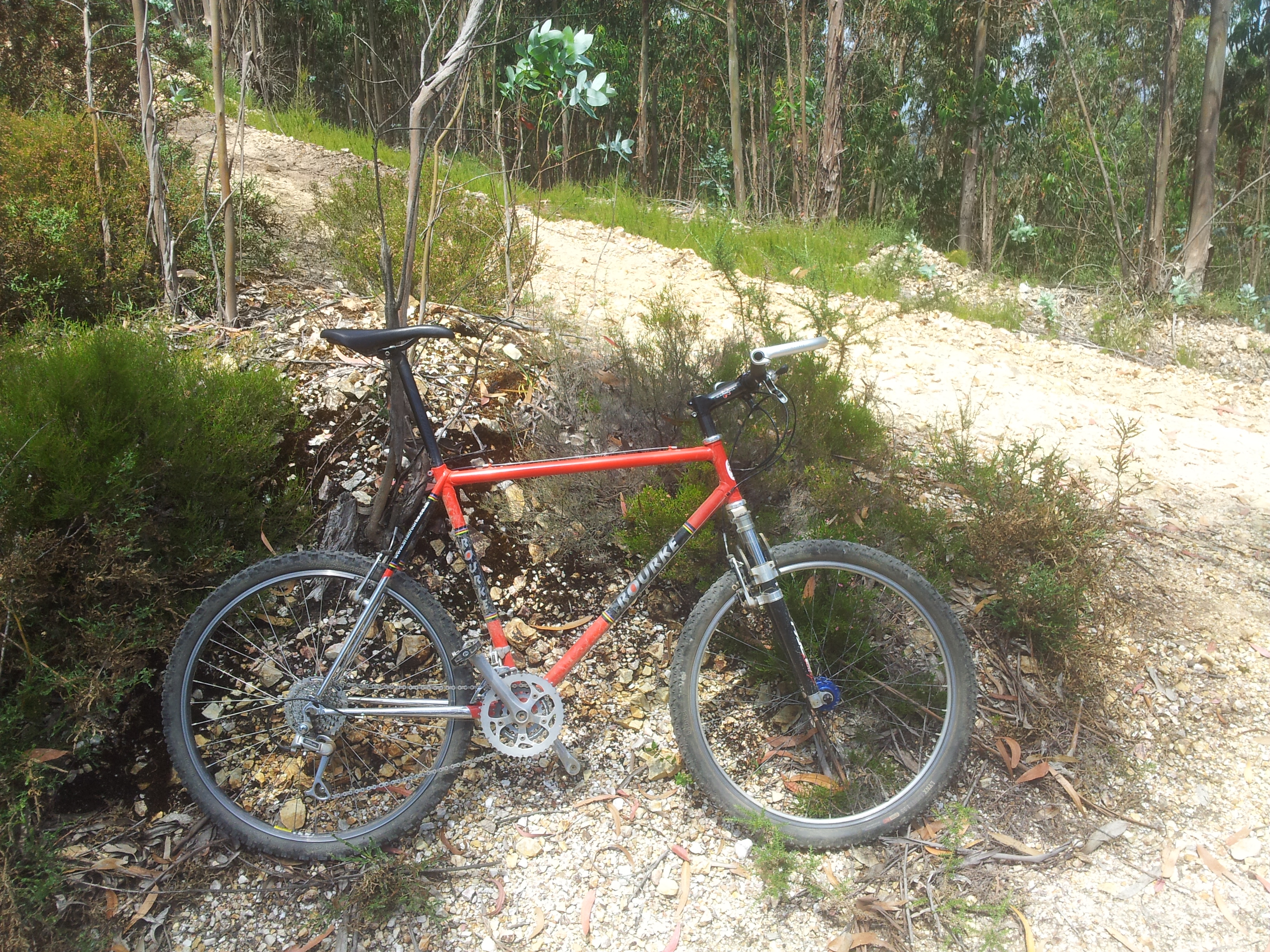

In the end I opted for the 11-34 HG 41 wide range cassette, paired with a 30 t middle chainring. On today's test ride, I only needed to change from middle ring one or two times, once for a fast road section, and once for a really steep climb where the 34 x 30 wasn't quite low enough. In effect, it's a 1x8 set up, but with the other two rings still there just in case. Ideally I'd add a 36 or 38 cog (removing the second smallest one to make room), but that's going to require some thought and additional expense.

I've just fitted an 11-36 8 speed shimano cassette, which I constructed from an HG41 11-32 with the 15 t removed to make way for a 36 t which came off an Alivio HG300 9 speed cassette.
The indexing seems fine, but I'm getting some pickup in the 11 t when using the middle ring, and when in the 36 t the jockey wheel's noisier than I'd like. I think I might be pushing beyond the limits of my MT62 rear mech.
Anyway, I'll test it properly off road on Tuesday and report back.

Today's test of the 11-36 x 30 t went well. A 50 km all off road ride with some long, tough climbs and fast fireroads, and I felt I had all the gear ratios I needed while in middle ring. I'm pleasantly surprised that the Deore DX MT62 rear mech seems able to handle the 36 t cog, although I did have to reverse the B tension screw to get enough distance between the cog and the upper jockey wheel.
