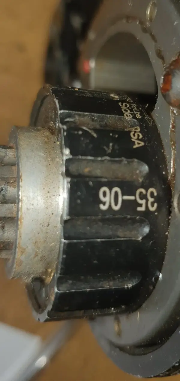

What type of bottom bracket tool
As above, not Shimano, to many splines there.
ISIS style, but not pointy enough.
So I'd go with the above. A picture search makes this seem correct.
So going modern for me but I think that's now the SRAM GXP tool (Was Truvativ GigaPipe/Howitzer) standard tool.
My original Shimano hollow tech tool fits my Sram GXP bb's.
We really need a photo of the cranks. Does the bb cup not have any model name on it?
Edit: I've gone back and actually clicked on the screenshot instead of just looking at the preview. I originally thought that the silver part in the thumbnail was the tool, but I can now see that's a chain guide and the black cup shaped tool below. I think that tool is the right size and spline pattern for the BB cup, but it's for axle less BB cups. The hole in the tool is for a socket attachment and won't clear the axle. You need to try a spanner type tool.
Having never used the GXP, same tool then all is good.

The cup is approx 43mm
Here's a pic from the other side
It didn't come with the cranks

yep, thats a truvativ howitzer external BB.
given that you don't have the cranks, you aren't going to be reusing it. use a pipe wrench.
if you still want to save it, you'll need a spanner, it's the same as a hollowtech 2 tool, there are about a tenner.
adendum
once you've got one cup off the axle can be removed and you can use your other tool on it.
