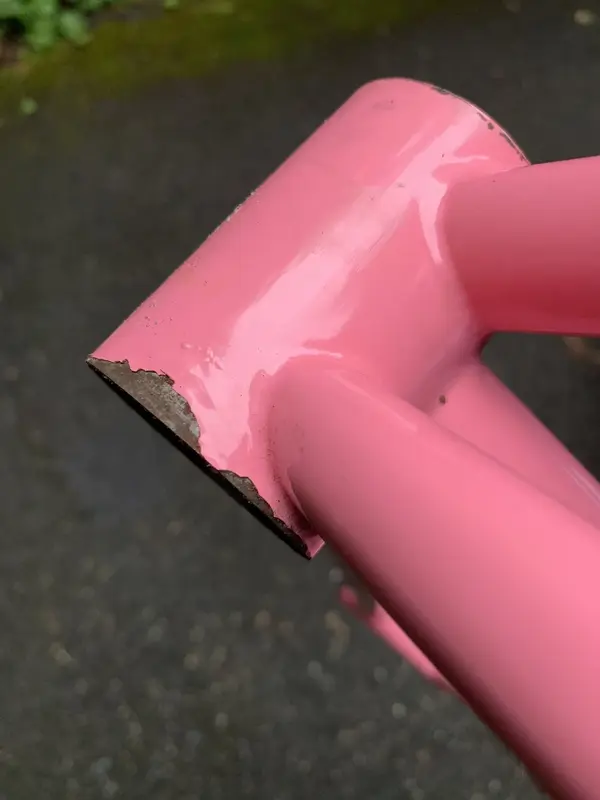

What to do when a bike looks like this.

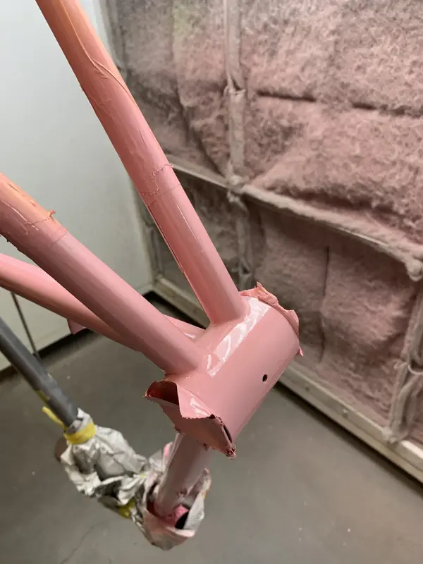

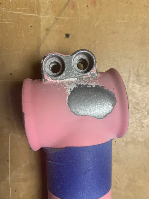

I bought a rusty cielo and cleaned up the rust. I experimented with feathering on stem since it needed a full redo. Feathering doesnt work. Just mask with straight edges.
My repair wont be in any museum but the rust is gone and the metal is stable.
I zapped inside of frame with fluidfilm.

View attachment 821302View attachment 821311View attachment 821312
