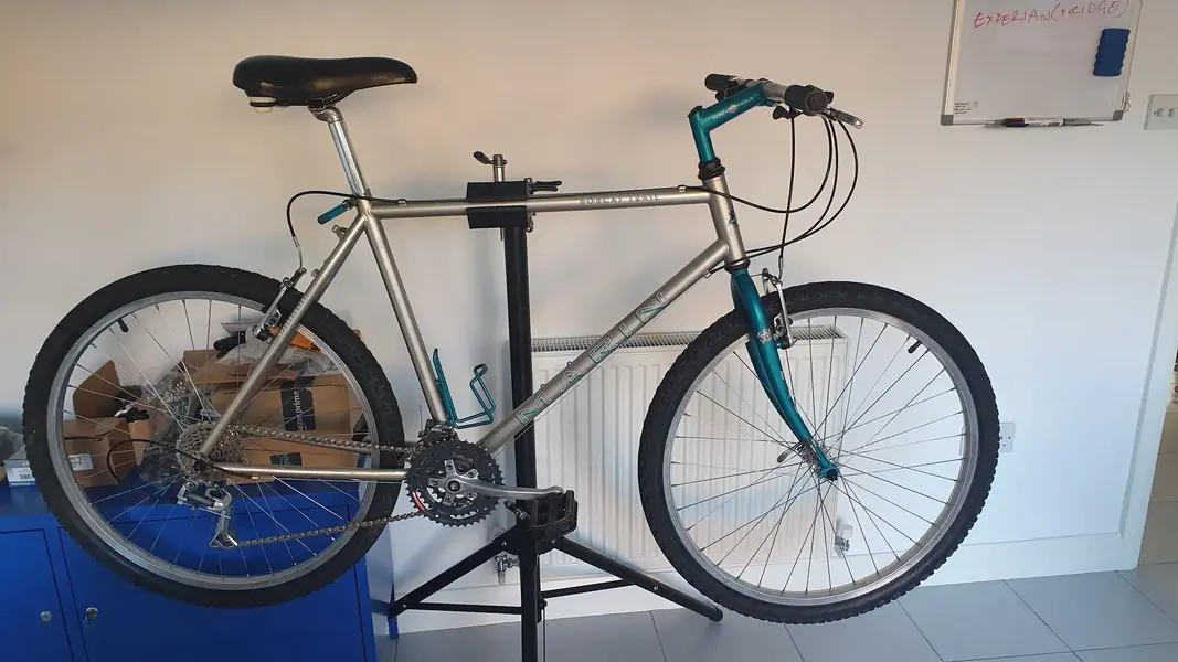

Currently I'm really enjoying doing up a lovely 1995(?) Marin Bobcat Trail (see pic attached) and have found that after giving her a good going over, reassembling and installing a new chain, my gears run perfect BUT the bikes chain has now started skipping!

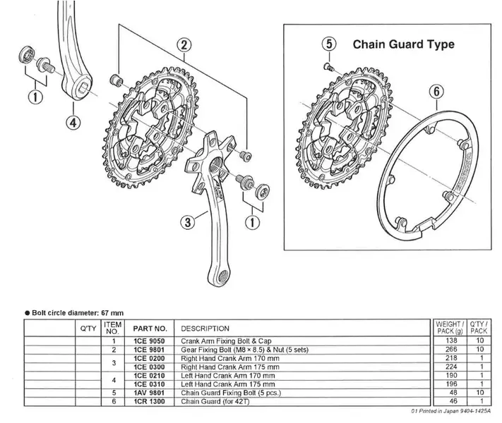

So, I ordered a replacement cassette and was looking for a replacement crankset when I found out the Shimano FC-MC12 (see pics for more info) crank on these bikes was recalled by Shimano in 1997 - amazingly, Madison, Shimano's supplier in the UK have agreed to honour the recall and replace the part. Happy days, but!...
I could be waiting weeks, putting me off the road and seeing as Shimano wont be giving me anything but the bottom of the barrel parts, is there another new crankset that I could install on this bike that would play nicely with the stock rear derailleur and BB?

If your looking for a NEW relacement try searching for Shimano 42 32 22 Square taper chainset.you should find a few options for around £35/40
If it were me, I would not buy a new crankset: most are all black and not really in keeping with the look of the bike. I would look for a good condition STX RC crankset from the 1990s: they are more in keeping with the look of the bike, they have replaceable chain rings, they work with the same 110-113mm spindle bottom brackets as the crankset you've had, and they're a nice little upgrade over what the bike came with (without being over the top). I would look at the For Sale section here first; if no luck, perhaps put a post in the Wanted section; failing that, look at eBay.
Thanks for your help. Will any square taper, triple crankset from Shimano do if it has similar tooth counts?
The stock FC-MC12 has 24, 34, 42.

Turns out the chain wheels can't easily be replaced. The outer and inner aren't too hard to replace but the middle serves as the bracket for the smallest one so can't be swapped for a new one.
I'm starting to see why so many people are upgrading to modern 1x and 2x systems... you just can't get the chainrings for older systems now.
Would I have more luck with a Shimano M739 crank? Seems to have three separate chain wheels:
Or, would I be better off upgrading to a modern system which overall might save me both time and money!
