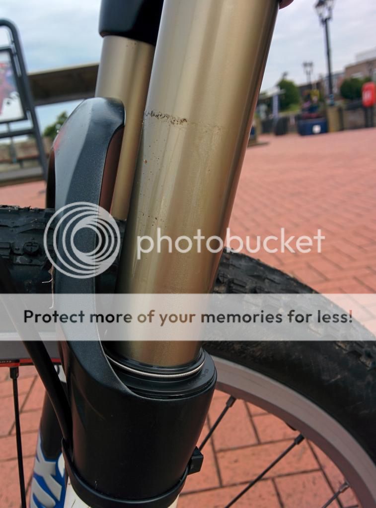

My set of F100s appears to be weeping/leaking slightly on the air cartridge side of the fork. I've come out for a quick spin this morning and have just noticed some fluid on the stanchion. It smells like fork oil and I can see a small amount of it sitting around the seal.
I've wiped the oil off the stanchion and from around the seal, and it reappears when I compress the fork a few more times. It doesn't look as if the seals have ever been lifted and lubricated..
I'm guessing that they need a service, although to be honest for the amount it will cost I'm tempted just to get a set of second hand Rebas instead..

Do a lowers service.
It'll take you 20 minutes and you can get the whole thing cleaned up and inspected. Then order some new seals if you need them.
And if they've had the foams soaked properly, or been stored upside down, that'd be a normal amount of seepage.

No special tools, seal kit is about 20-25 quid.
35 quid isn't a bad price, might be worth asking about the condition of the stanchions as well.
Looks like a normal amount for a freshly lubed set of forks. Seals may well look undisturbed if the forks have been lubed the right way, ie lowers off, instead of the lazy way ie seals prised up.
How did they feel when riding, are they holding air?
Go for a proper ride and see if weeping settled down, before blowing your money on a service. If you do get new seals make sure they are the newer SKF versions, they feel much nicer than the older ones.

They ride fine, and they hold air fine. The only thing wrong with them is the lockout isn't working..
