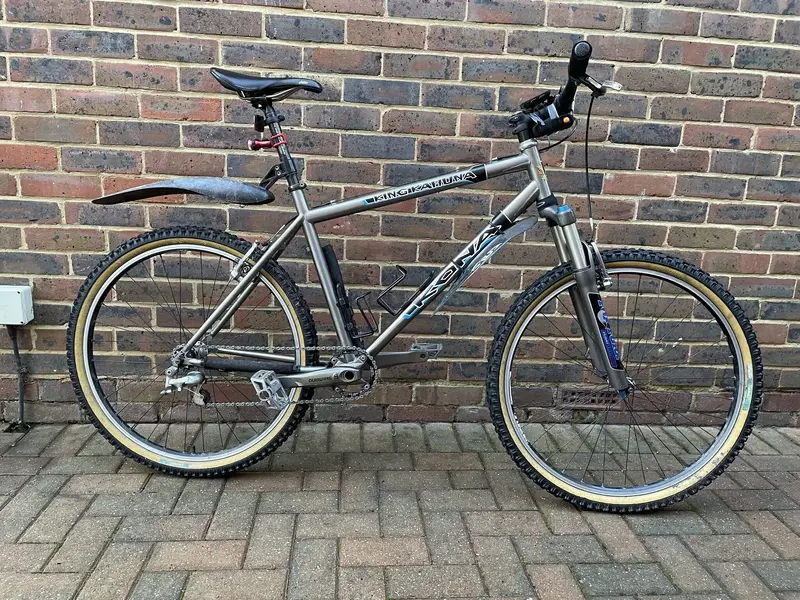

The front end after swapping flats for risers felt very, very quick steering. As the forks needed a service anyway, I pulled the legs off, removed the 20mm spacer from the air side and am now running 100mm of travel. Hopefully it’ll ride better, but that is a lot of travel on a ‘97 frame!
The chainstay is still roughly horizontal and I’ve got 20mm static sag.
I’m still loving this. The combination of a top spec frame, forks and brakes with shitty wheels and drivetrain means than I can grind through the sandy slurry without getting hung up on wrecking it. Honestly in the space of just a couple of months riding, there is noticeable wear to the rims. Also, not having any gears means that there are no issues even in the thickest gloopiest mud. I just need to man-up to be able to keep turning the wheels 🤣
