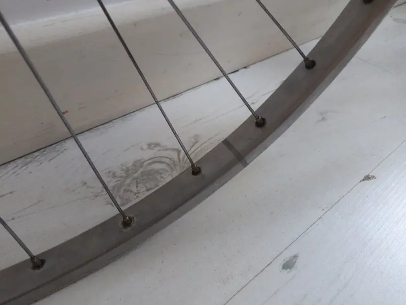

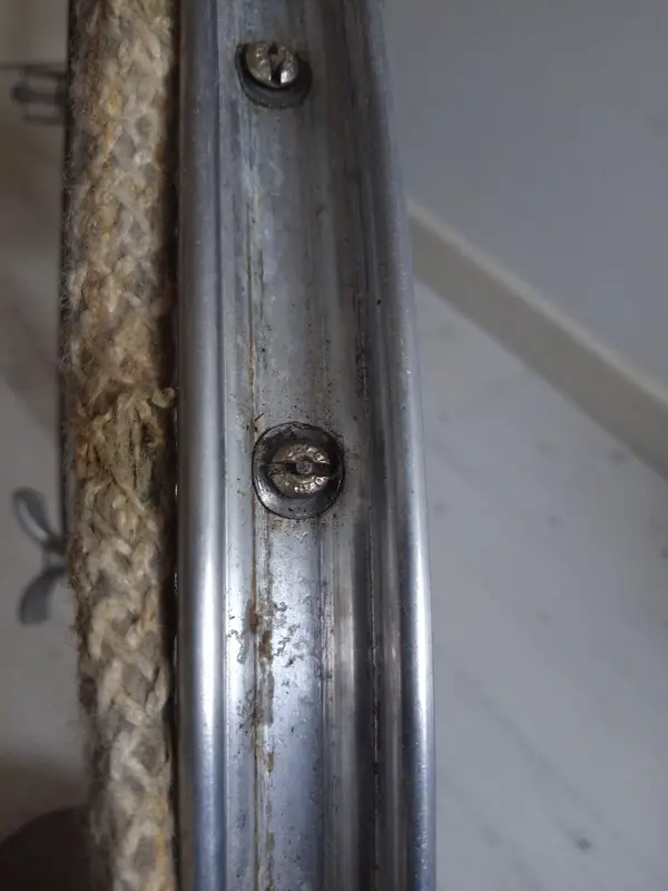

IMG_20220404_172635_559.jpg IMG_20220404_172746_686.jpg outer width is 25mm and internal is 16mm. depth from rim edge to internal shoulder is about 6.3mm this measurement seems fair bit deeper than any other 700 rims I have!
Anyone have any ideas what rims these are?

I think I can see your problem - that's a really shallow rim so the only way you'll get a modern tyre one is to ensure that the beads on the opposite side of the wheel are pushed as far as possible into the rim well (not that there's much of one). Even then it'll be a struggle. We had a tool that was supposed to be for fitting solid tyres which I would use whenever we were faced with a really tight tyre/rim combination - had to take care though as it was easy to put enough force in to damage things.
Agreed! It's shallow yet the shoulder for the bead is deeper by about a 1.5mm !
So tight going on but baggy when in.
Definitely going to have inflate slowly whilst helping the tyre to seat true
Certainly want nice new supple sticky beaded tyres I don't want to roll the bead out whilst cornering 🙄
If I could get a positive id on the rims I might be able to find someone whose found a good fitting tyre. Can't really afford to keep buying tyres in the hope I get lucky.
