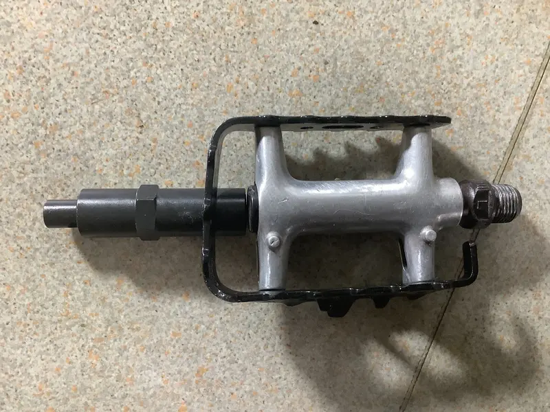

I’ve got this tool. Doesn’t fit inside dx pedals

I’m assumig this is the same tool I’ve got, the socket doesn’t fit into the DX body (the top part where the Nuts are). Same for XT M735. I did them both recently

Out of interest, do you have a caliper to measure the diameter of yours? Mines 16.8mm. Maybe what I have isn’t the same since apparently the above poster says it works on their Dx pedals. There were probably older versions
Mine is 14.95mm OD the 11mm end and 13.5mm OD the 10mm - give or take a tiny bit - the battery was running low on the calipers so only got one go to zero and measure before it gave up!
Well that solves it. I’m guessing since it was your dads, it’s fairly old. Mines more recent and since shimano Pedals are no longer made the same way, mines only for working on newer pedals.
