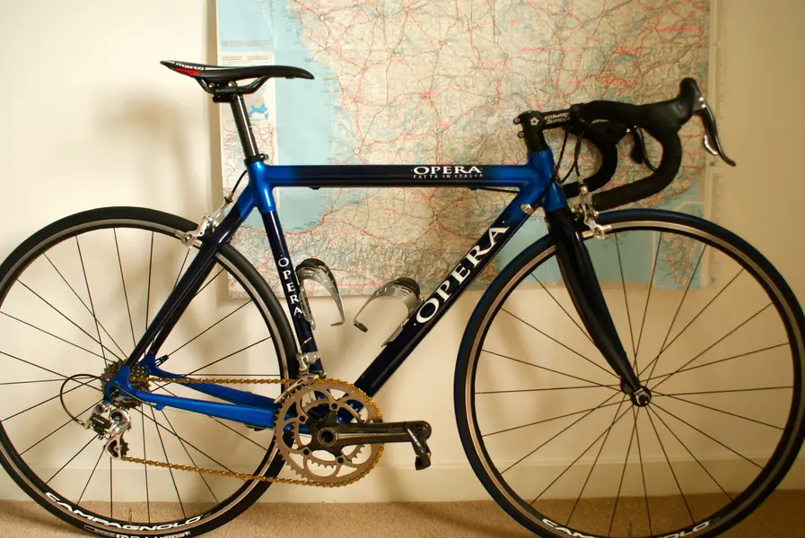

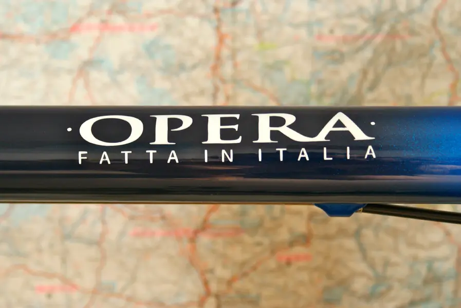

This is my much loved Opera Leonardo. Carbon main tubes, fork and wishbone seat stays, aluminium lugs, chain stays and head tube. The bb is stamped 00 and the seat post is 27.2 mm.
The fork, wishbone seat stays and bb/ chain stays seem identical to some Pinarello models of the time. I've read about the history of Opera within Pinarello, and noted the Opera line appeared to change the bonded carbon/ alu manufacturing very quickly, and I've only seen one other frame like this.
In terms of the questions around bonded frame longevity, it's been all ok so far.
It's still my only road bike - a joy out on a sunny day.
Any information and comments are welcomed.
Thanks
Tom
