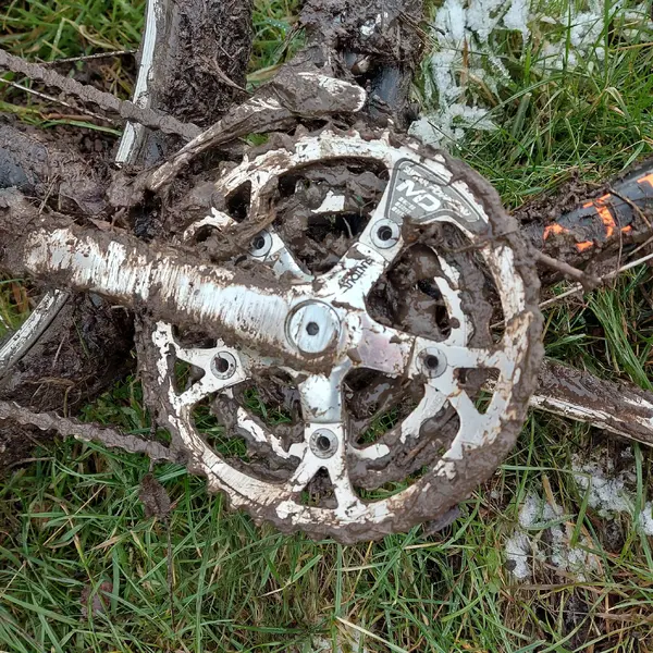

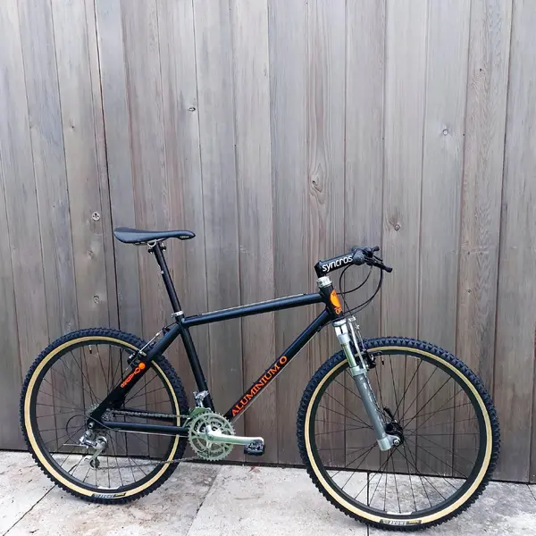

Big fan of Suntour XC pro here....especially MD. Both my black Aluminium "O"s have a MD chainsets.
#1 has a mix of Suntour, Mavic 840 rear mech, Shimano DX thumbies and an M732XT front mech.
#2 'mudplugger' runs more Suntour ~ chainset rear mech and thumbies. Front mech still M732XT....for no other reason than I had this to fit and didn't have a spare XC pro at the time.
If it can handle this....it's a dependable groupset!

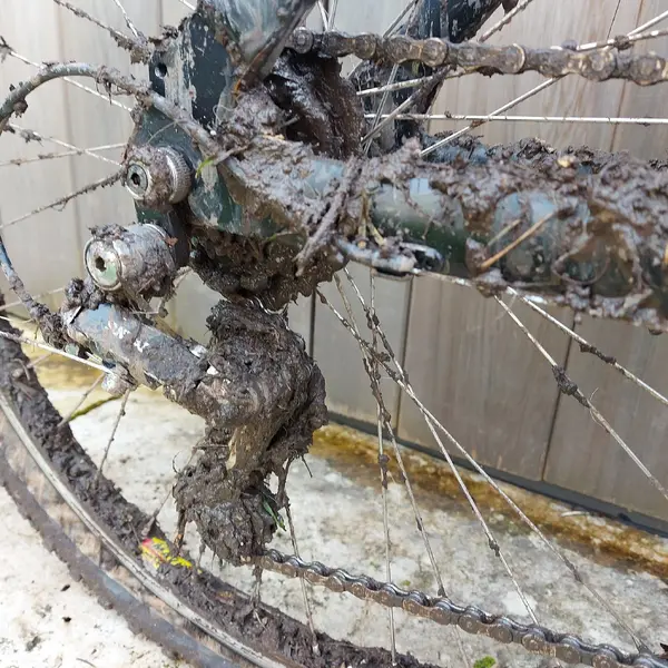

Long Cage Suntour XC Pro (Non MD on rear)
Shimano HG70 12-28 Rear Cassette on Shimano DX hub (Rider wheelset) Chain is KMC 8/9 speed.
Was still shifting through this. In the dry, the mix and match combination has no compatibility issues, shifts smoothly.
