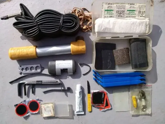

Contents of my kit. Most youll recognise buin addition
- hacksaw blade for sawing and sharpened for slicing
- piece of plastic milk bottle for fixing tyre cuts
- cable ties
- narrow strip of inner tyre for misc tying purposes
.... and yest the blackburn multi tool has allen keys but they are of lower quality than individual ones that i take in order to lessen risk of rounding bolts.
Only thing missing is flat bladed screwdriver for mech adjustment but the blackburn tool has one which may or may not fit.
