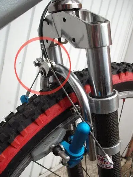

I’ve looked pretty much everywhere but can’t really find one that looks like it’ll fit? Most of them are the bolt through ones intended to work like the cannondale force 40. However I need one that looks like this
Slides onto a boss on the steel arch with a spring behind and used a circlip to hold in place.
Anyone have a spare tucked away or some way of fashioning one?

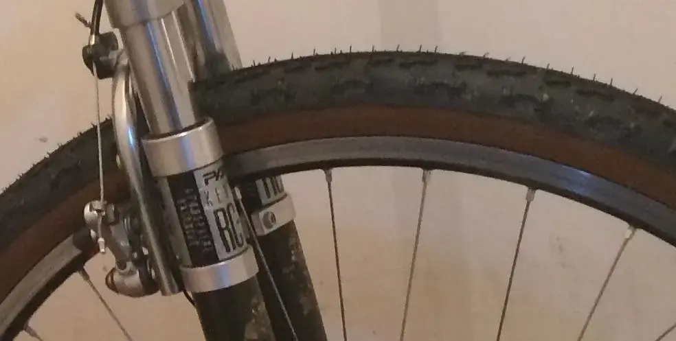

I've used a tektro one. Admittedly on a later RC35 mxcd bridge, so I'm not sure of the differences. It only needed minor work to fit, in the form of a shorter bolt, i think.

Yeah the later ones were screw on, but this wouldn’t work, the hole is too small, I’ll get some pictures of how it’s supposed to work. This doesn’t screw on, it pushes on, then secured with a circlip.

Is there enough material to drill and ream the hole to size? Do that if there is.
I have used an M-Wave rocker in the past with relative success. From memory, I just took the insert out of the rocker and literally tapped it home with a rubber mallet and not much effort. Fitted a circlip and had no issues with it. FFDB0379-3A69-474D-B3E6-636C4F7B71F2.jpeg
