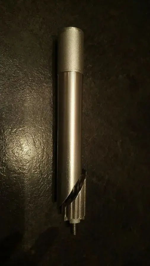

Ideally this problem wouldn't arise in the first place, but it has, so I'm looking for a bodge-less solution, which I thought I had, but I may need to do some "fine tuning" :)
Results...
Steerer O.D. = 28.6mm (ie. 1"1/:cool:
Steerer I.D. = 24.8mm
Extender O.D. = 25.4MM (ie 1")
So 0.6mm diameter difference between inside of steerer and outside of extender.
Which is not a lot when you look at the thickness of the aluminium extender, it'd be quite easy to remove the excess (if you had a lathe etc). Could file it off, but it'd be laborious, and probably uneven.
Will make enquiries tomorrow about pressing out the steerer.
Problem solved, took it to a local engineering shop who turned it down to 24.75mm, leaving 40mm at one end to sit atop the steerer, which is plenty for this build :)
velomaniac":1q2rg0ik said:
Did he reduce the diameter of the wedge aswell ?
No, but the wedge was a smaller diameter than the rest of it already. I did measure it the other day but forgot to note down the size.
I have tried the extender in the fork steerer and it fits like a glove :)
Good work!
Earlier I measured one of my 28.6mm quill stems and it was 28.5ish (OD), but the fork was 27.5 (ID) - go figure!
