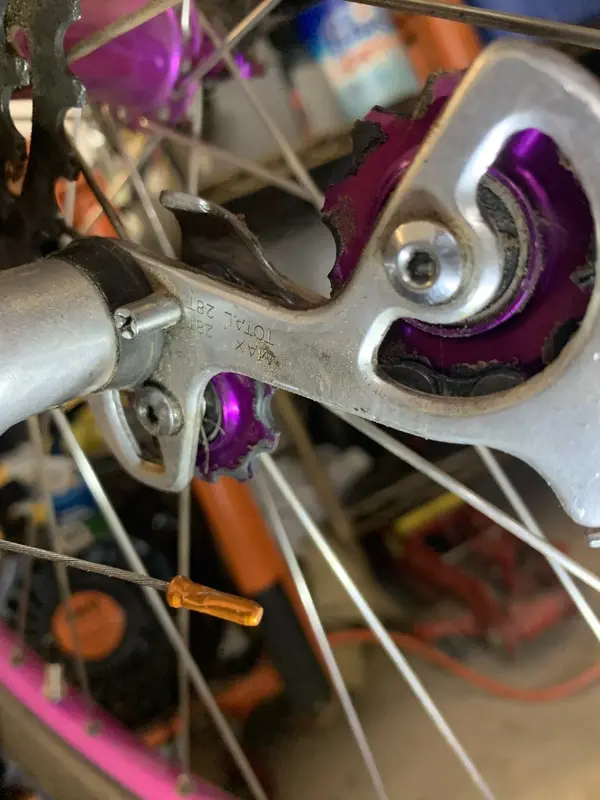

The difference is very subtle on the flick of the outer cage bit.

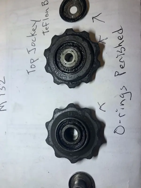

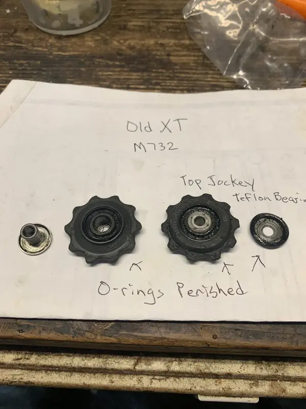

So an offset 10T is the problem, not surprised as 11T was used a few years later I think, all 10T seem to be straight through.
That's the one. The difference is clearer on the inner cage plate.
Yes, since the top jockey is offset that's the difficulty. The top bushing is worn, but not as bad as the bottom, so I might get away with using it with a jockey wheel with the right diameter bear ID (unless I am missing another obvious solution).

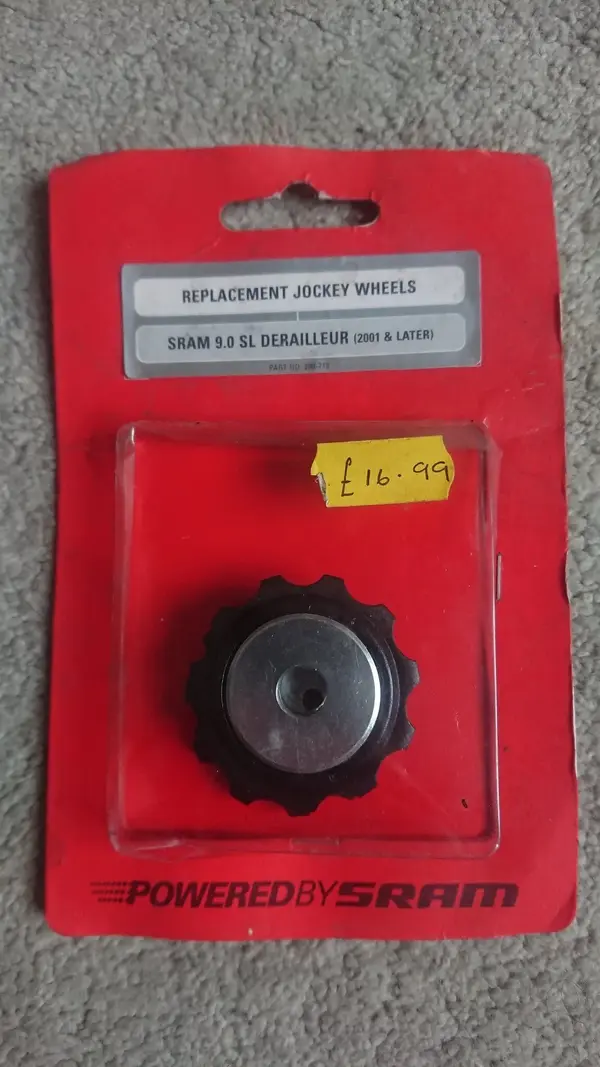

Well, these say 2001 onwards, but they were so cheap and have more similarities than most replacement jockeys, so I'll give them a go:
Or should I leave them unopened as a genuine example of NOS?
