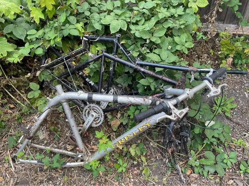

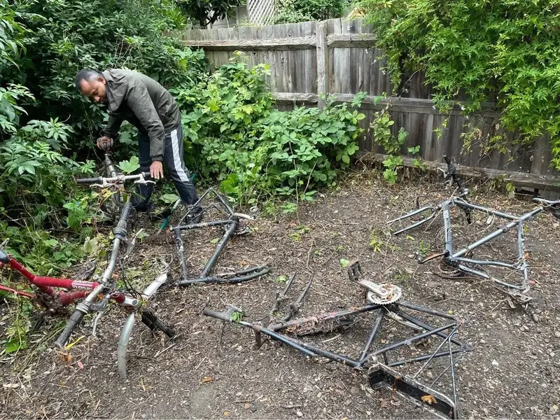

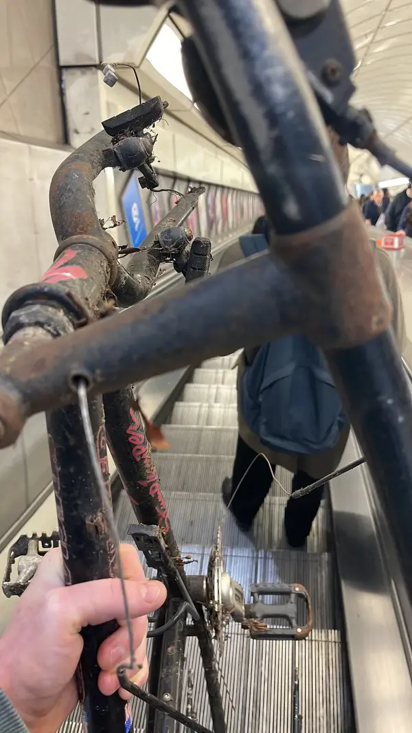

Picked this up on Facebook marketplace the other day for free. A very nice lady had advertised a job lot of all things bike related she had found underneath the overgrowth in the new house she had just moved into. She told me to take whatever I wanted as she just wanted it gone from her new trendy garden.

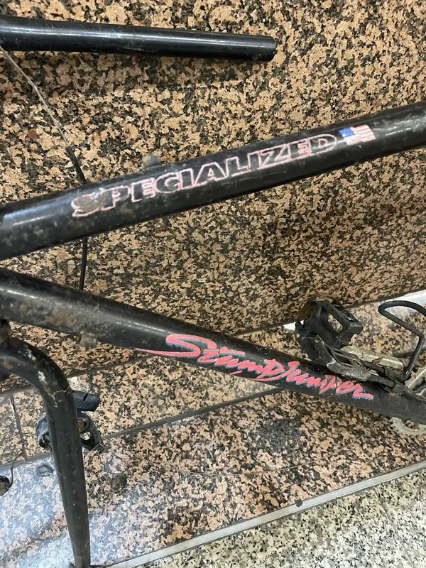

I noticed that iconic Stumpjumper font from a mile away and thought it would be a nice little project for the cold nights ahead.

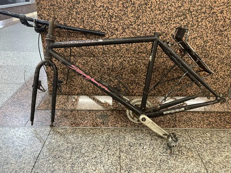

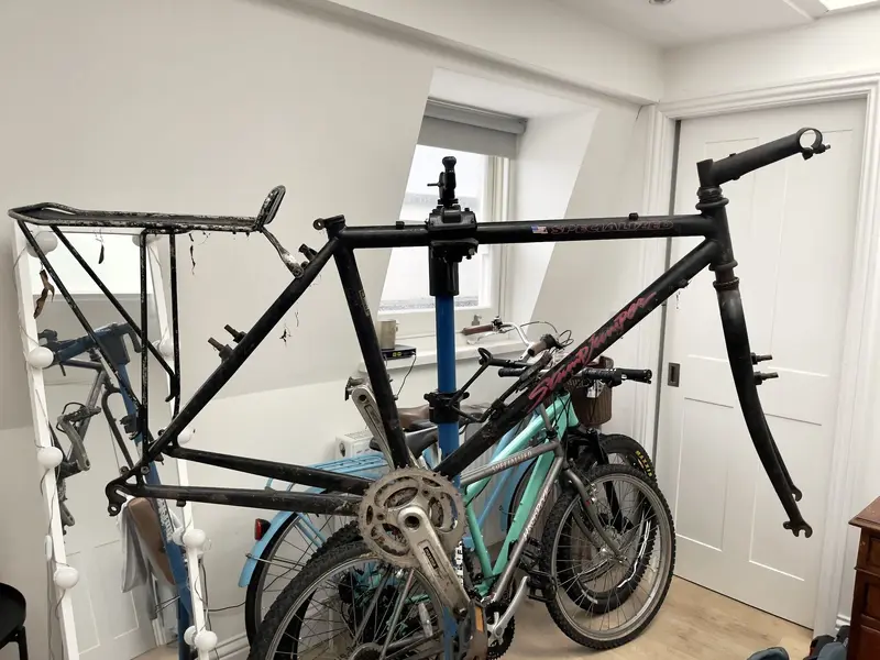

From doing some digging online, it seems to be a 1990 Stumpjumper Epic? but not entirely sure. Can anyone chime in with some more info? I'd love to know a little bit more about the bike and its history.

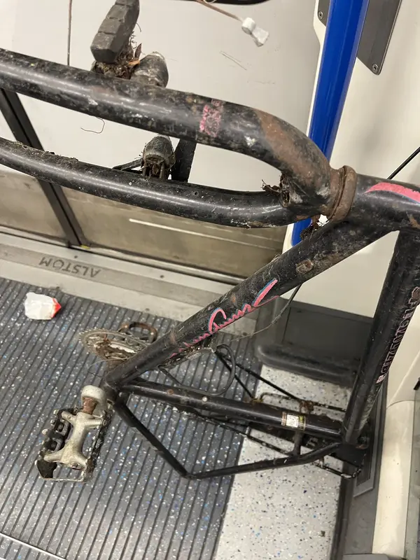

Also, I'm currently in the process of stripping it down and have run into some minor speed bumps along the way.
- The crank arms feel like they've been welded to the bb, even though the crank puller has fully engaged?
- The forks seem to be stuck to the stem. Rust I'm guessing?
Any help would be greatly appreciated!
PS. I got the tube out to get this as she lived right by the station. To say I got a few looks would be an understatement.

Both probably need some penetrative fluid (plusgas is a fave on here) and there are a couple of helpful techniques, namely;
1. Stem. Wind the bolt out of the stem at the top, so that it's proud of the top cap. Then, using a block of wood and a hammer, hit the bolt back in towards the stem. This typically separates the quill from the stem and frees it off.
2. Crank arms. Prior to using the puller, I would probably again tap the crank onto the BB using a block of wood and a hammer to free any fused rust. Then use the puller.
Usually no need for brute force.
Sometimes both are waiting games with soaking required for a few days.

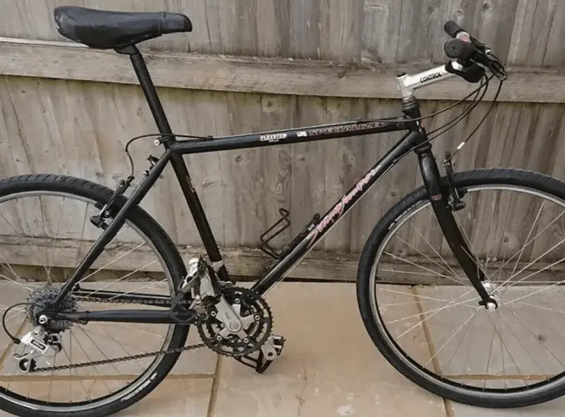

Nice find, its not an Epic as you describe in the title though.
Looking forward to see this develop, please keep us posted!
Its one of these -

Ahhh I see!
Sorry, I read an article (https://www.thevintagemtb.com/post/1990-specialized-stumpjumper-epic-9x032) which led me to believe it was an Epic.
Either way, nice little project ahead!

Ok makes sense! no bolt at the top so one less job...
I will keep you posted on the progress.
Thanks for the tips, much appreciated!
