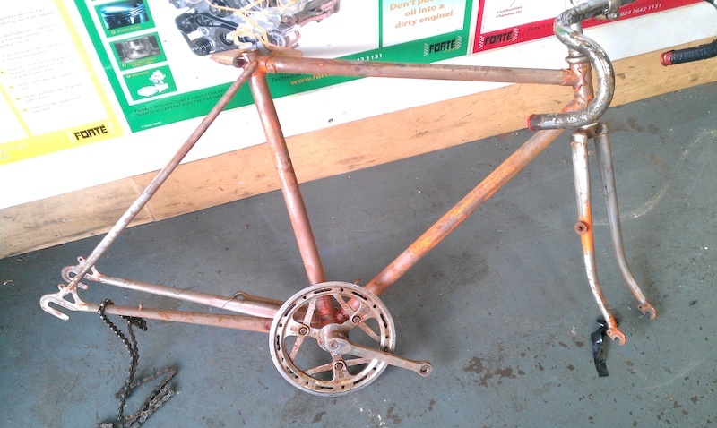

Cheers. I'm raw'ing the paint off of it and making it a silver colour. As for wheels, I have a spare set of 27" in the other room, so they'll go on it. Just hope the single speed works without having to re-dish and re-space.
This is what's been done so far, now to sand off the rest.
If you're going for a bare-metal finish, then thin linseed oil (from an artist's supply shop, not the thick orange stuff) will provide excellent protection - it dries to a hard finish, doesn't rub or scrape off easily, and if it does you can just re-apply it with a rag. You can also pour it inside the tubes to protect against internal rust. Two coats protected my Carlton from June to March with absolutely no rust underneath.
The thick orange boiled stuff also works, but it has an orangey finish with repeated applications.
i have beening after those on ebay keep getting out bided worth 100+ from what i saw on ebay worth doing tho if even to keep for yourself :)
if you stripping it why don't you have the brake cross member brazed lower so you can use a 700c wheel. i had it done years ago on a claude butler elan in the late 80's.
cheers dave
If I was desperate to put 700c wheels on I'd use a rear coaster brake and fit a different set of forks. I'm with Lae on this one though spend as little as possible, fit mudguards to fill the massive void (700c would allow you to drive a bus through), etc.
