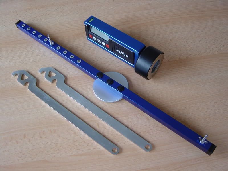

Nicest tool I have made is a adjustable wheel adaptor to hold the digi camber gauge for setting up my car :D

The camera was out and I had been in my tool storage area (under the bed :LOL:) and it caught my eye :
The laser cut quick release 'spanners' are my design for setting up the front suspension. They repace the dampers when the car is on stands, the bottom setting is full droop (to stop the bottom wishbones resting on the chassis) and the top setting is the 'perfect' ride height for setting up the tie bars and camber :D
The tool with the plate in the middle is all my design and made by me :D It holds the magnetic camber gauge and is adjustable to suit from 13" to 22" wheels. Other than the rivnuts and magnet plate, all the fittings are stainless :D
The camber gauge has only been re-anodised to match :oops: but I did need to re-pot the magnets and re-set the spirt bubble :D
