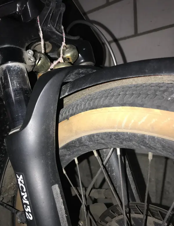

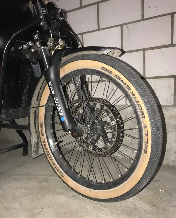

I think a rigid would rattle everyone and everything out of the cargo box :LOL: . Still a consideration though. I like that idea. Maybe a slight compensation with a larger front 20" tire? I looked into 20" Trials forks at one point but the local R&M mechanic/tech frowned at this as being TOO stiff.
She is an absolute pig though! A pig dog! Chain eater too. That’s why I went with Sram X01 chains as they last forever for the money. Was getting maybe 12 weeks a chain on the cheap Shimano stuff.
I need to build new wheels (Hope or Race Face…maybe DT Swiss) as these cheap Alex rims that came stock are failing at the nipples. Also if you or anyone knows of a high end 20” suspension fork, please let me know!!!
whats the axle to crown measurement. you maybe able to run a 26" fork with some modifications to shorten the stroke. not like you need 100mm of travel on a cargo bike, 25mm would be great, have 25mm positive and 10mm negative and you'd be golden I'd have thought.
Good question and good idea. I have a 98'/99' Sid that is visually disgusting, maybe that?
Measurement is: about 295 mm.
There is room from the current tire to the crown for at least another 20mm. Maybe I can get a 22" tire on there for no good reason as well.

sid SL are 434mm ATC (I think they are only 80mm travel at though), so knocking out 50mm and you are still long. :(
I think you may have to accept a slight increase in head angle if you go down that road.
other option is looking at higher end SRs. the raidon for example that they do in 20", they are air sprung and a reasonble fork in the larger wheel size (never had an issue with mine in a 27.5" version).
This looks like a proper 20" fork, if you can find one anywhere?
I can live with a head angle increase. Will make the bike a tad less squirly too. I looked into modding 26" to 20". Seems to only be possible with Manitou 1,2 or 3's and access to a lathe. But in my search, I stumbled upon a few recumbant forums with fork recommendations. Also, I think springs and polymers is less drama in the long run over air/oil seels and frequent rebuilds. Thoughts?
I will look into that, thank you!
