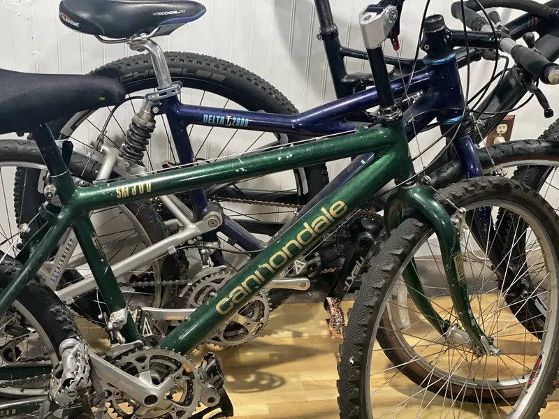

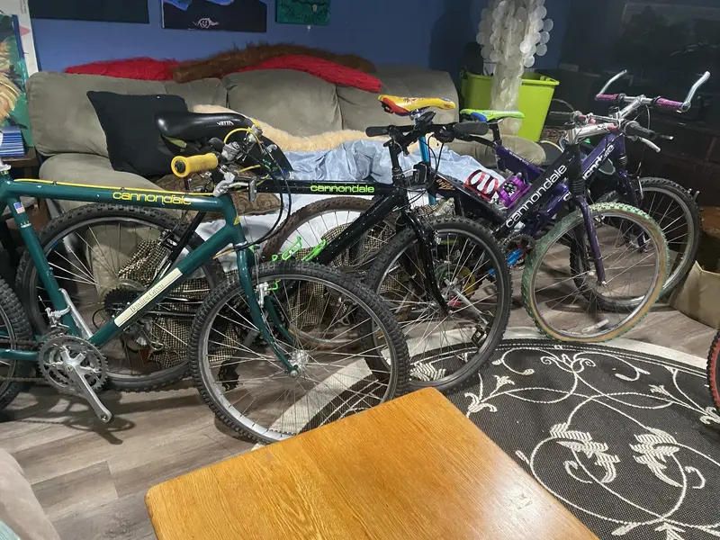

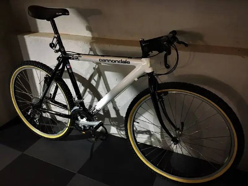

On my 1991 SE Omega, the fork is an RS1 but I weld a Force 40 pulley on the bridge AFF25967-164D-4C38-BDD6-4A17A425CED0.jpeg
Late to the party but here we go!
1987 sm500, 1988 SM600, Bowling green bike, 1990 SM700 chameleon, 1991 SE Omega, SM omega, 1MB, SM800, 1992 M600 Patriot, Delta V Omega, Delta V 2000, 1997 M800… that’s what I have pictures available. I have a few other oldies but not pictures

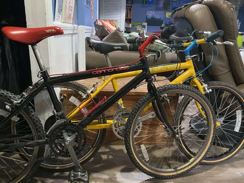

Very cool collection you have there! I especially like the Jade Green color of the '91 SM800. It's refreshing as they're almost always black / orange chameleon. If my memory serves me right, it sparkles rather nicely in direct sunlight.
Now get those '91 Omegas built with proper components! :D
Thanks brother! A 91 jade SM800 was my first cannondale back when I was 11 so I had to track down another one for the collection! My brother has the alternate color (orange chameleon splatter) with less than 10 miles on its life.

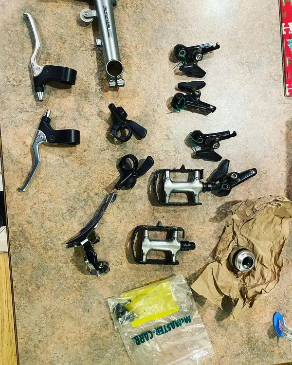

ALWAYS try to do proper components on the omegas for sure! A few items might swap mainly because of the lack of write ups on what would have been correct. For instance, stem for the SE/SM if you chose the factory option of the RS1 fork vs pepperoni/flex stem combo. My choice was a period correct Cook Bros Racing. Probably not what they did but it will match the crank and BB. I have the entire SM build except Mavic/campy wheels. I’ll start some build threads when the fun begins. I also try to use NOS so these builds take me forever hahahahaha
