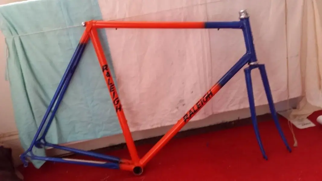

SBDU 753 frame identification

Midlife":ajazhsml said:
SB 4314 will be 1981-1982 . Pics would be nice :)
Shaun
It's this one, I asked him to weigh it because there were no 753 decals.
2800g was the lower end of the guestimate presumably because it was wobbling about on the scales.
Chainstay "dent" looks wrong for 753...........BITD it was longer and shallower, mind you I'm a child of the 70's :) Rear dropouts somehow look odd, probably the blurry photo.
Shaun
