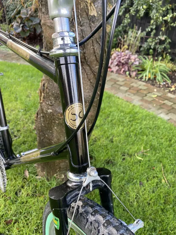

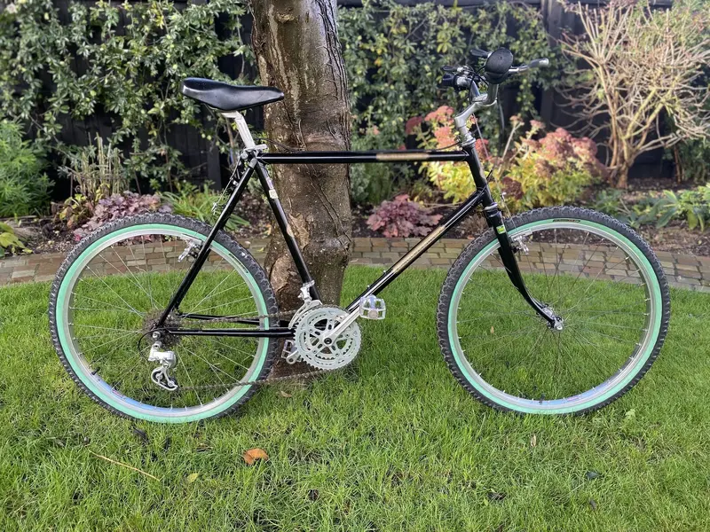

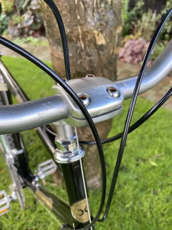

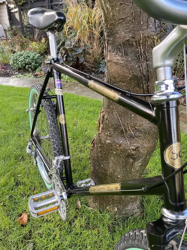

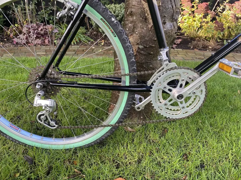

Hoping some cables for the S & G arrive today. No idea what it ā€œshouldā€ have had but a going for black Dia Compe for the brakes as both levers and arms are DC, and some Suntour branded for the shifting. A silly detail but thought Iā€™d like something fancy.
I was running the old bike with a Shimano 8 speed chain, will probably go back on - but I read in the spec it had a black/gold DID Lanner chain which I think would look great. I do have a black/gold Izumi somewhere but think itā€™s a track chain - will that be too wide for this?

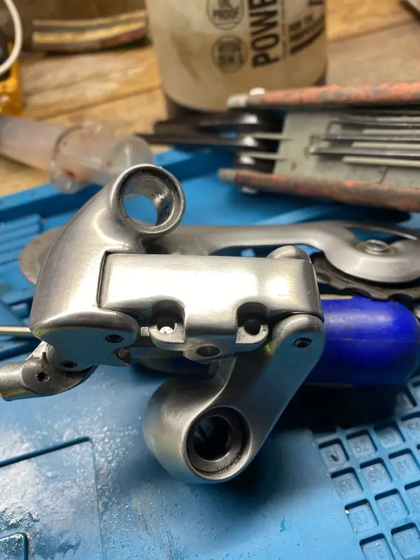

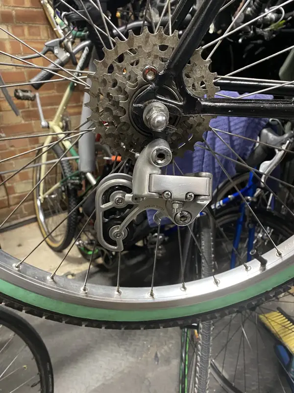

Sometimes things grow legs, I started to look for a Suntour Lepree front mech to match the rear. Was looking like a Ā£50 purchase by the time Iā€™ve paid import etc as could only find in the US. XC front mechs I had a choice of several and found one for Ā£15 in the UK. Got me thinking, it wouldnā€™t match the rear but itā€™s technically a better mech. I had an old XC mech in the drawerā€¦ā€¦ā€¦..would a swap around of the rear cage from the 3 pulley Lepree to the XC mech work?
On the blue mat of possibilitiesā€¦ā€¦.. 2BE35B33-8570-4FFF-8D68-CF5A82EF7C96.jpeg
Apart from the cage the mech bodies are very similar. Some difference around the limit screws and the XC doesnā€™t run with a cable adjuster, but crucially the cage pivot is identical.

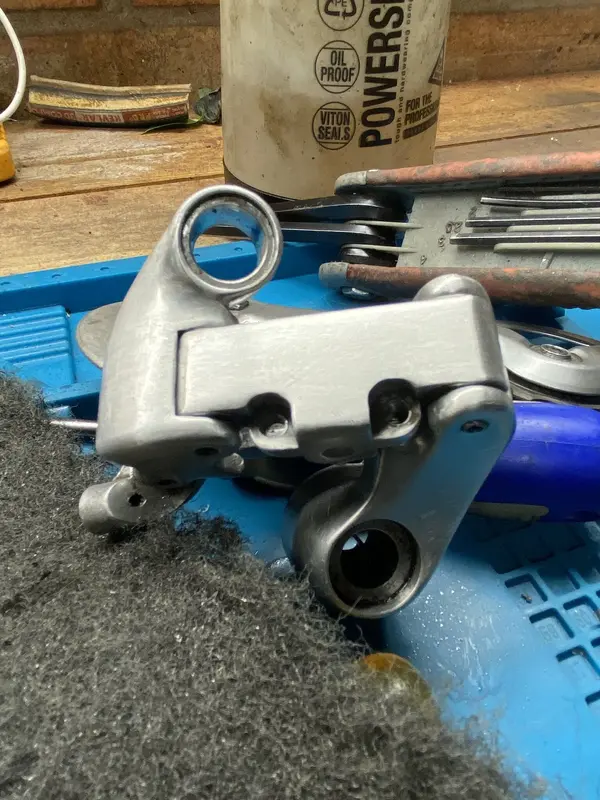

The XC on the right had some battle scars and was a bit scabby so I took a metal file to the gouges followed by some 400 grit then a polish. Not looking for perfection just not damaged. Will be looking for some more decals thought! EB072010-5F28-47A7-B626-53F525495C15.jpeg
After a clean and an oil Iā€™ve ended up with a 3 pulley XC rear mech which will match the XC front which is now on its way and a long cage Lepree as well!

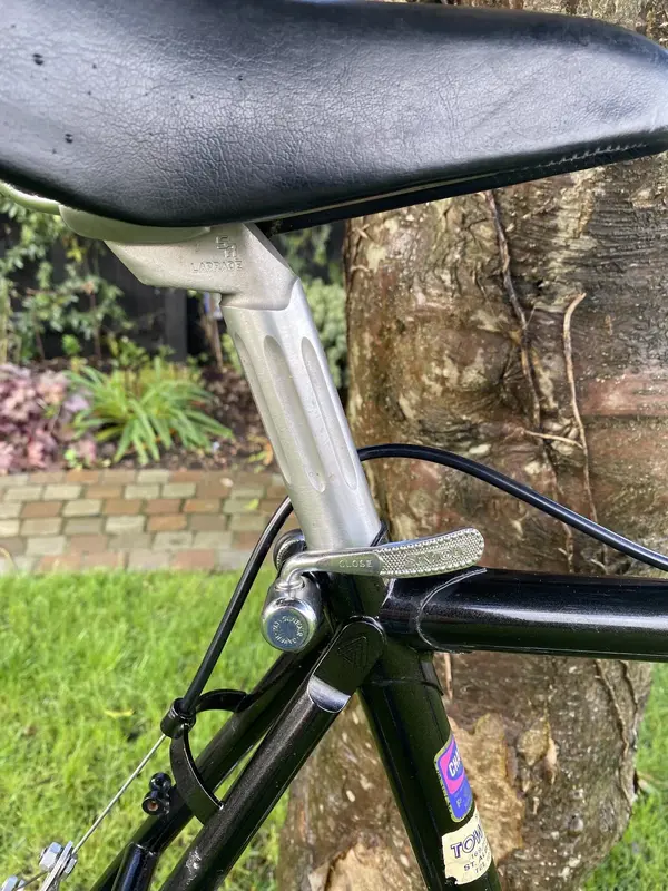

So XC front and rear mechs, Iā€™m sure Iā€™ve got a pair of shifters somewhere. Could only find one in the drawer then remembered.

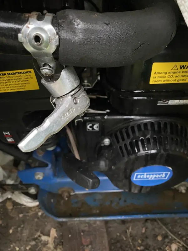

I have a grave confession to

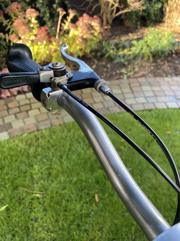

make, Iā€™ve been using a Suntour XC shifter as the throttle control on my plate compactor on the gardenā€¦ā€¦it was out of necessity, Sunday afternoon and the one on it broke and I had loads to get done.
And bugger itā€™s also a left/front mech shifter so I now have a wanted ad for a right/rear shifter to match. Iā€™ve still got the ones on the old bike but they donā€™t look right now!

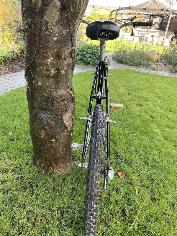

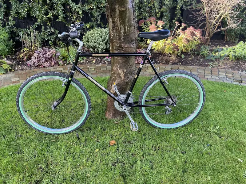

Front mech arrived today, much nicer than the original one that was on there and in great condition. Not sure what the correct terminology is but itā€™s reverse sprung like a rapid rise Shimano mech. The LeTech one on one of my other bikes is the same.
The black/gold Izumi chain I was hoping to use was much too short - I guess being a track chain that was always going to be the case! It did fit the mechs and cassette ok, maybe look out for another.
Rear mech refitted and you can see the extra pulley now itā€™s under tension.
Ended up replacing the bottom bracket too, I had only ridden it briefly previously but was rough as a badgers arse when reassembled on this bike, bearing surfaces on the axle were shot. Found one on eBay but not much to choose from at 132.5mm long.
And just realised thereā€™s some crank dust caps and a pedal reflector lurking in the box I stripped off it! Will sort those out when I get round to doing the chain.
