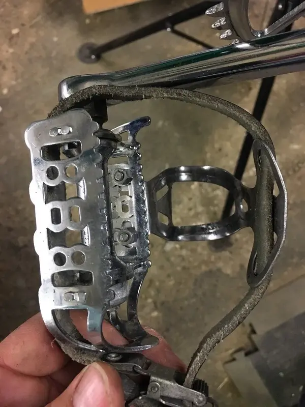

Only recently converted to Evapo-rust. Very impressed, not too harsh & doesn’t burn the skin.
1. Strip down parts as much as possible,
2. Thoroughly clean & de-grease. very important.
3. Immerse pedals in a plastic Tupperware/take-away/ice cream tub. Seal the lid.
4. With awkward sticky-out bits (like the clips) these went in a larger container, but would need loads to cover, so I wrapped them closely in kitchen towel, soak this and made sure its in close contact all over. Then pop them in a container with some evapo-rust and let it just soak up through
5. 12hrs latter, can be less, can be more, remove and rinse.
6. Then I spray them up with WD40 to expel all moisture out of the pits and tiny rust holes, this is very important, miss this, blink, and there will be a fine layer of rust on them again.
7. Finally a polish up with MAAS, the best all round metal polish on the market.
