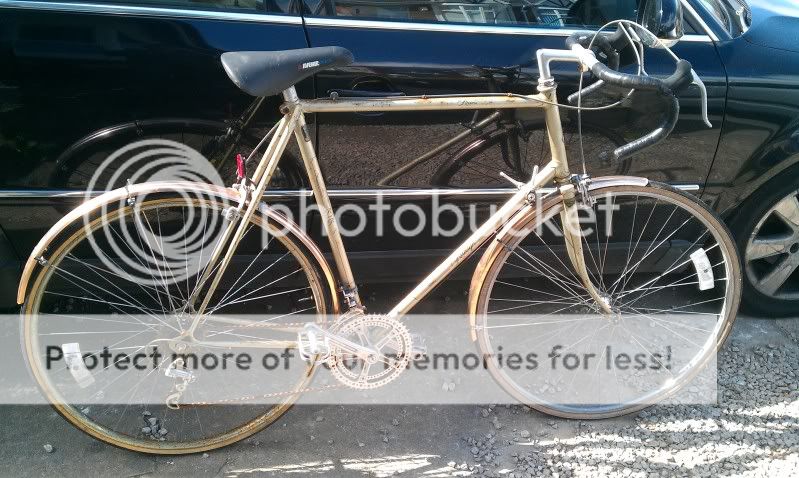

So I got the bike, it's in much better condition than I thought! Literally mint, just minor surface rust nothing deep and a little polishing of the chrome and it'll be perfect. It had new tyres and pads put on it so it's ready to go.
One problem, I had to have the wheels taken off for it to get in the car.
I've put them on now when I got home but the back brake is getting stuck on the one side. They're Weinmann type 500's.
Here's a (really bad) photo - http://dl.dropbox.com/u/13387317/New%20 ... to0064.jpg
I've tried moving the arm etc it just keeps going back. What could it be? Totally new with these old style brakes. Want to get it up and running to take a spin round the block tomorrow before I strip it and clean it up.
Cheers.
They're a bloody nuisance these calipers! You need to centre the caliper using a very small hex socket on the hex nut under the black plastic cover. Can't remember the size, but it is something like 5mm. There used to be an "inverse allen key" tool for the job. If you don't have the tool to hand, you can try the following:
loosen the (10mm) nut on the other end of the centre bolt that holds the brake caliper on to the frame a bit, so the caliper is loose. While it is loose, pull the brake levers so the pads are now on the rims (i.e. the brake is on). While holding it there, re-righten the nut. If you're lucky, the caliper will now be more or less centred on the rim...
Most decent calipers of the age are centred using a standard 13mm cone spanner, but not these... There are some earlier Weinmann calipers that I've yet to find a good way to centre.
Nick
ps, to get on the road in extremis, you can always take an adjustable spanner to the centre bolt. The black plastic cover slides off (with a little effort) revealing the hex end of the centre bolt. You can centre the brake with a small adjustable spanner on two of the flats. Note that I do not recommend this, as the steel is soft and it is very easy to round the hex off, removing your key to having a centred caliper...
Nammonk I owe you a virtual beer, I didn't have a inverse allen key but I did the second thing you suggested. Loosened the nut on the back, at one point when trying to tighten it fully it went over to the left. I figured out that you can loosen it or tighten it a little and it more or less adjusts it, fits perfect now when squeezing the brake.
Everything works on it! Chuffed, typical British weather for the rest of the week now probably though. Will take it for a spin when some sun comes out.
