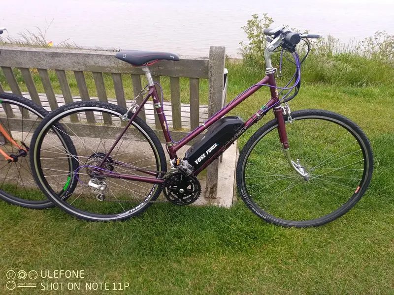

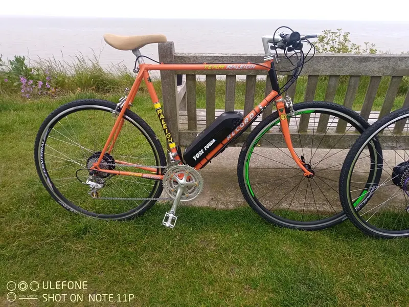

I did look at them but there were a couple of things I didn't like about the concept with the cost compared to what I bought being the most off putting. My kit cost £391 where to get the equivalent from Swytch would be more than 3 times as much. At their cheapest their kits are still vastly more expensive and I'm not sold on the front motor design or the battery mounted high up on the bars with those kits.

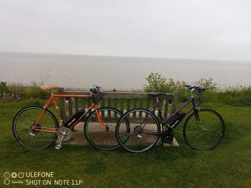

This was only an experiment for me but I'm so pleased with the result thus far I've since bought a 2nd kit and using a spare ladies frame built another bike for my wife, so including all the new bits I needed to buy to complete this 2nd bike to Mrs H's exacting standards (lots of purple) I'm still nowhere near the cost of one equivalent Swytch kit and have 2 fully functional electric bikes.
So far the only issue I have found with my particular kit is where the bottle cage mounts were too low on my frame I needed to add more mounts. Because I was building from a steel frame base that wasn't particularly difficult using a 7mm drill and a rivnut kit and the frame I used for the wife's frame had no bottle cage mounts at all originally. Time will tell as to whether our initial happiness with our kits is well founded but so far so good.
I'll post some more pictures of both bikes later as were of for a ride along the coast on Sunday to give my wife's retrolectric Falcon a decent run.

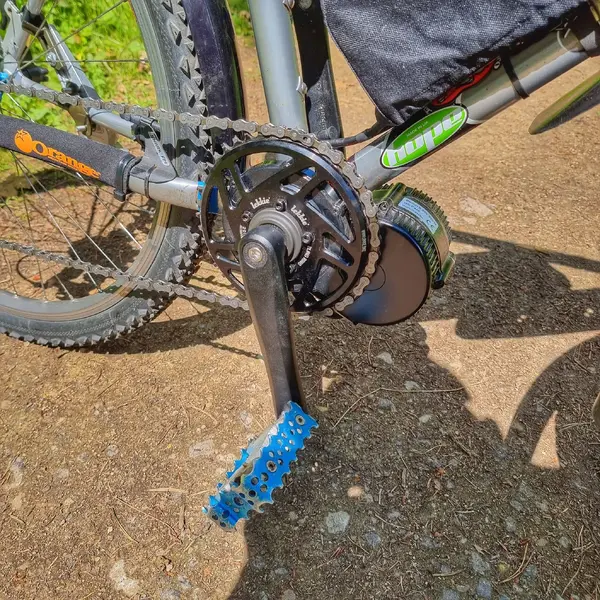

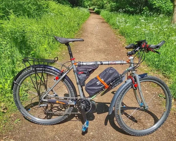

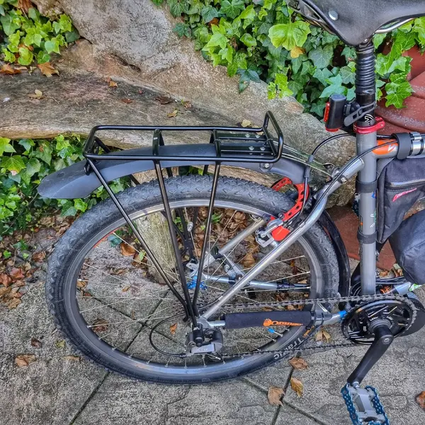

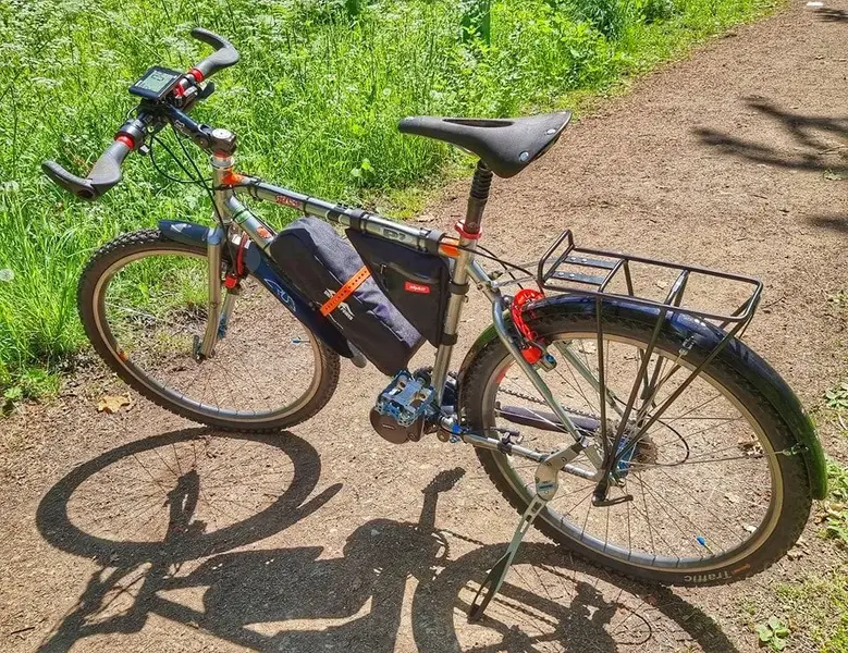

The build is done. Moved the kit across from a 17" C16R frame that I've sold & put it on a 19" P7 which is better suited for me. I put standard SKS mudguards on but they're too skinny even for the 1.9" tyres so ditched the front for a plastic affair without stays & put a cut off rear mudguard behind the seat tube & cable tied a MTB mudguard to the rack. I've left the Crudcatcher in place as more protection for the battery. I may put disc brakes on it some time in the future. I've got an old disc wheelset so would just need disc forks.

Well so far so good with this thing. I've liked it so much I've built another for my wife which we took out on its maiden voyage today. She deliberately went out and found every hill she could and couldn't get over how good it was at hill climbing.
I've not put that many miles on mine yet but so far battery usage has been minimal even including the new found Queen of the mountain actively seeking every incline she can, its going to be interesting to see what the range is before I have to re charge it but so far using a relatively light bike seems to be really helping with the range.
