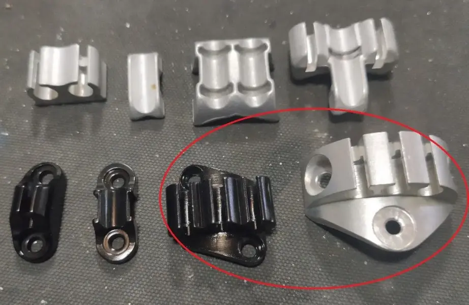

I have a stock of rivet-on triples, designed for 31.8mm (black) and 35mmØ (silver) tubes, circled.
Alternatively, various single and double stops, hose guides etc. for welding or rivetting if that helps.
